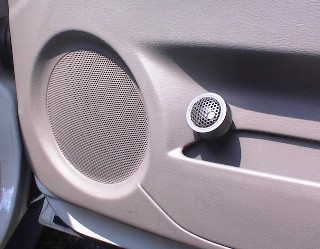

Maybe I'm easy to thrill, but I picked up a pair of CDT's on a closeout special that I got a tip on from DYohn, who used them in one of his family cars.  This model uses the silk tweeter.  I've been happy with them for two years now.  My thing about damping all the metal in the doors and using a baffle for the mid mount goes with anything you use, though.  If I didn't do all the preparation, I can't say how I would like these components.  Oh, and I used the swivel mount for the tweeter instead of flat mounting them into a preselected space on the door.  A contour in the door panel allowed for this so that the tweeter still remained nearly flush with the mid driver.  It doesn't look like a cool finished piece of work like a lot of glass projects do, but it has allowed for some very fine adjustment of the front soundstage.

Posted By: jmelton86
Date Posted: April 03, 2007 at 9:51 PM
That works. The only reason you didn't flush them in the door is cause you didn't know how you wanted them pointed? Very smart! Looks good.
Are you kidding?  That install looks awfully clean and slick.  It looks like it sounds *great* ... I really like that angled tweeter to, it looks really cool.
Those are CDT Classic series comps eh?  I ran those speakers in an active setup for awhile.  They sound awesome like that.  Can't say I was too fond of the CDT passive xover though..
