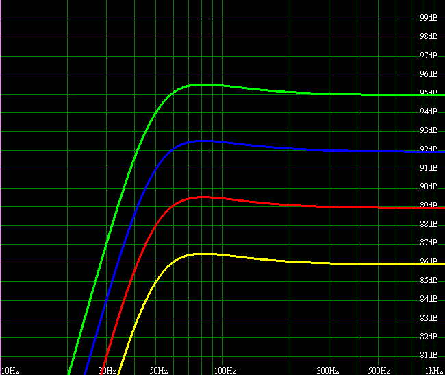

As I believe I correctly stated in my second post here, if he adds one more 12 and another amplifier of equivalent output, he will net +6db.
Yellow = 1x12" @ 1w/1m
Red = 2x12" @ 1w/1m
Blue = 2x12" @ 2w/1m <-- +6db Gain
Green = 2x12" @ 4w/1m
posted_image

The blue curve indicates a TOTAL POWER of 4 watts - TWICE the power, AND twice the cone area. It says so, right there:
2X2=4, reference output X 4 = +6dB. It is showing a total dissipation of 4 watts. 2 watts PER WOOFER, at one meter. The red line is what you need to be looking at, if adding one more identical subwoofer system. IF adding another subwoofer (i.e. 2 times the cone area, which is +3dB) AND doubling the power (another +3dB) into both subs, THEN you can add 6.
1watt/1woofer = 1 watt dissipated = reference
2watts/1woofer = 2 watts dissipated = reference +3
2 watts/2 woofers = 4 watts dissipated = reference +6
4 watts/2 woofers = 8 watts dissipated = reference +9
Do you see the progression? Twice the power (per woofer) affords twice the output (+3dB) The next step would be:
8 watts/2 woofers = 16 watts dissipated = reference +12
So, I still stand on my calculations of earlier. (Nice try though... ROFL ...and PLEASE take that in the intended spirit!!!)
(BTW, I like the title of your graphic... "gaindebate" posted_image posted_image posted_image posted_image posted_image 5 Stars!)

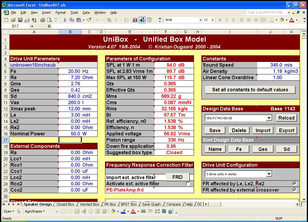

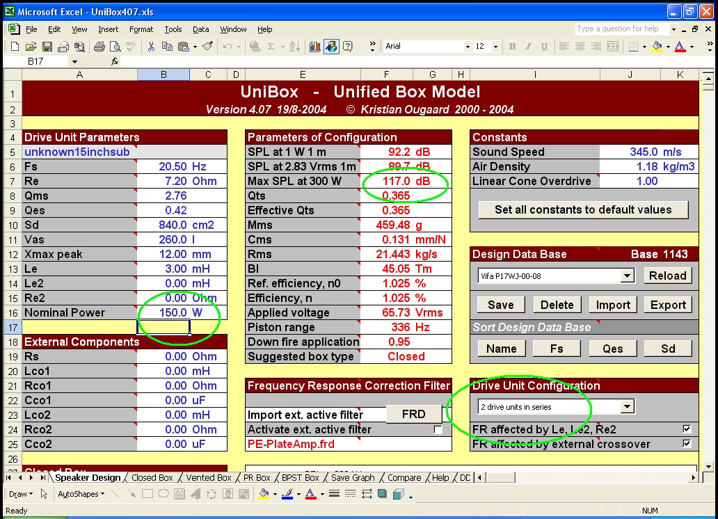

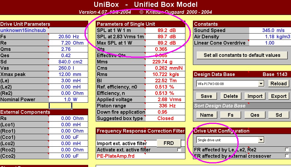

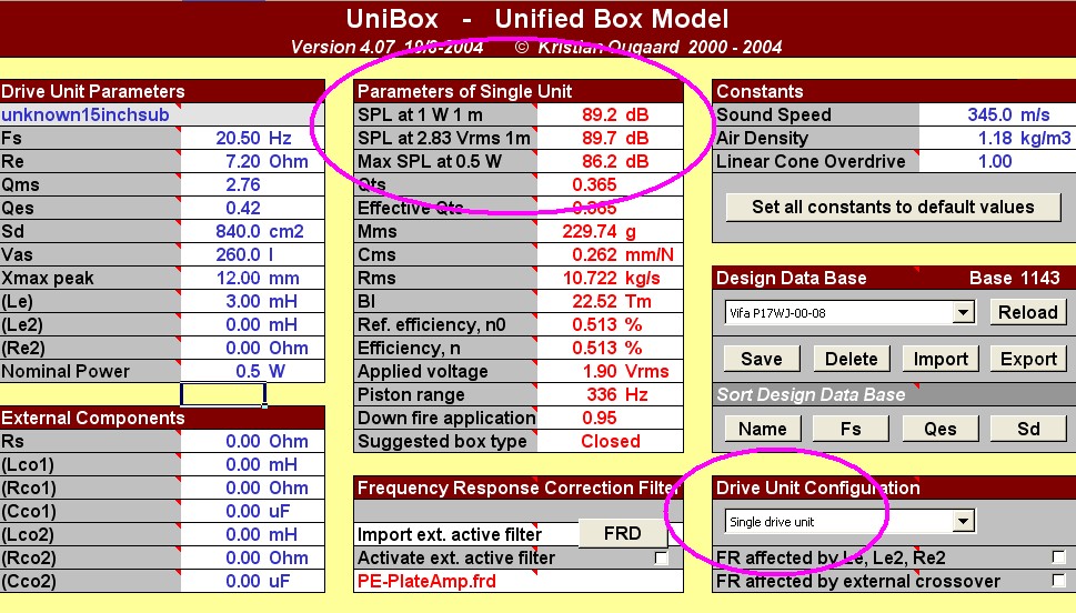

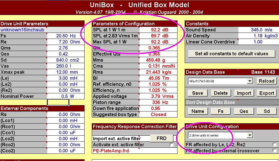

haemphyst, Unibox confirms what sedate is demonstrating.  The nominal power as shown in Unibox is power to an individual driver.  The circled area on the right of the screen shows number of drivers.  SPL is shown circled in the center.
A single sub with 150 watts, yielding 111 db:
Now, two subs but each only have 75 watts for a total of 150 watts, yielding an increase of 3 db:
This is the single sub with double the power, yielding a 3 db increase:
Unibox demonstrates that either doubling cone area or doubling power yields +3db.  This last pic shows both, for an increase of +6 db, which is what the OP said he wants to do by doubling cone area and doubling total power:
And so I shall stand as well (although I must admit, tenuously, as DYohn also has told me what you have stated ;)
(Expand the images and flip back and forth through them.  It looks like a decisive conclusion to me.)

Anywho, uhh...  well heamph I still believe I'm correcct.
The blue line does not represent 4 watts, it represents 2.
It says so right in the little box I used to make WinISD make the graph.  Each of these lines represents a 12w6 with 1 cft of air space assigned to it, with the wattage I listed.  I believe this is for the input power for the box, not the individual drivers.

Doubling the SYSTEM increases the output by 6db, not 3db.  All this individual woofer talk is running us in circles.
Again, our yellow line is 1x12 @ 1w/1m and our red line is 2x12 @ 2w/1m... or a mirrored system.  A 6db increase.
100db+100db = 106db.
posted_image

haemphyst, I don't believe you looked at the graphs closely enough.  The center box shows max SPL and total system wattage.  The circled box on the left is the power given to a single driver.
I didn't say that the OP was doubling power to each sub, but doubling system power.  The graphs demonstrate what I said.  Leave them up on your screen and look through them again.  It is, of course, true that if I halved the power to the single driver the SPL would decrease by 3 db.  Your logic with that argument DOES NOT account for the added cone area gain.  You are doing nothing but adding and subtracting power with that reasoning.
So, I've shown that Unibox calculates +3 db gain SOLELY by doubling cone area.  In addition to what I've already shown, I've also looked at it using one driver compared with three instead of two, and the results stand as previously calculated.  System power remains the same whether it is one sub or three, but SPL is calculated as +3 db due to doubling of number of drivers alone.
Add that picture to the ones I linked before.  It shows that with three drivers, each with 50 watts for a total system power of 150 watts...115.7 db.  Compare this to the graph that shows two drivers with 75 watts each (114 db)...still 150 watts total system power.  A net increase of 1.7 watts (roughly half of 3 db) due to the calculation for the additional single driver but no added power.
Now, why do WinISD and Unibox calculate additional SPL for merely adding cone area when system power remains the same?  Because, I think, it must be true.
Edit:  sedate, we are just arguing the same point with two different proofs.  But I understand your demonstration as well as the one I put forth.  (BTW, you are a silver member;  you can upload a file of up to 500 Kb.  I normally take a snapshot of the program using Simply Capture which saves a 2+ Mb file of that size in .bmp format.  Then I pull it up in MS Picture It and save it as a .jpg file.  That drops the file size down to 200-some Kb.)  Ha ha, yeah, like I'm telling you how to use modern technology :)

There is a way the programs deal with it.  You input amount of power to the driver that you are working with.  When you multiply the number of drivers the program gives them each the power that you inputted.  It seems to answer the question quite clearly to me, but what I said is that I'm telling the program that this is one amplified enclosure...not the two separate amplified enclosures that this topic is concerned with.  But it should all be same if total power is kept in mind.
You tell the program how the drivers are connected.  There are changes made due to the different ways you connect the drivers, but I see the same +3 db calculation due to number of drivers alone.  It's not defeating at all, but a tool to build great speaker enclosures.
Here's three more pics of the program's calculation for max SPL.  First is one driver with 1 watt.  Second is one driver with only half of a watt.  Notice the -3 db decrease.  Third pic is two drivers connected in series, each driver with only half a watt for a total power of 1 watt.  haemphyst and you are saying that since it is still only 1 watt, and you can see that both drivers are given half a watt, it should be the same as the original 1 sub-1 watt SPL.  You see here that Unibox adds +3 db for the additional driver.  And when you look back at the single driver with half a watt, you see that now there is a +6 db increase due to doubling of power and doubling of drivers.  Also notice the change in calculated efficiency when the second driver is added.
Anybody who models driver enclosures are going to get this type of projected SPL response based on number of drivers and total system power.
