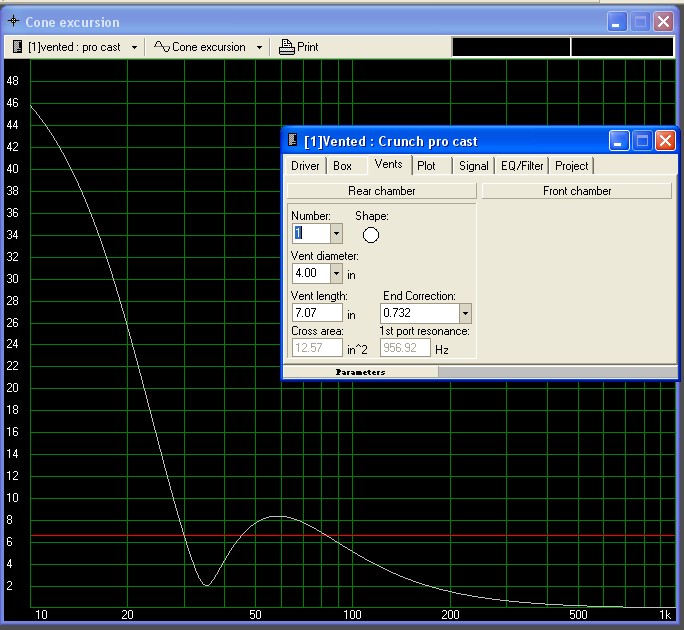

After already replying about tuning, I used my lunch break today to enter data into WinISD to take a look at your sub.
...but hey!  You're welcome!
Read my thread on using WinISD, stickied on top of this page.  Use the program as I descibe to look at some of the different sub drivers that are in the database.  Don't just read through my article, use it to learn.  Download the program and work your sub up.  You'll start getting it.  You're not going to learn everything about venting enclosures through answers in a forum thread.
Double check your info on that 658 cu in thing.
(DYohn, after your post I entered 658 as sq cm Sd...Bl looks right with that entry.  It looks plausible like that.)  But , now that I can see cone excursion,  this sub will exceed excursion with more than 200 watts in that box (at ~60 Hz!).

Sealed is much easier and in many cases the best box type to use (e.g. JL).  The old Crunch demanded a vented box, though.  The Xmax was a problematic concern in such a large box, but it would not have had any low extension whatsoever in a sealed box.  The graph I posted a link to (earlier post) was taken from my WinISD workup and shows a pretty decent response, almost akin to a sealed box response.  The problem was power input which might have to be kept reasonably at 200 watts or below.  Here is a cone excursion graph from the same program model showing what happens when given 300 watts ( but keep in mind that the parameters you gave are iffy, as I protested earlier ):  crunch_procast_cone_excursion_300w.jpg
The response, centered at 60 Hz, rises above the 6mm Xmax to about 8mm.  That indicates that the woofer will bottom out with that much power applied.  A smaller vented box could solve this problem but the sound quality would suffer greatly, with a poorer, more abrupt response curve.
