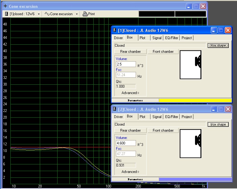

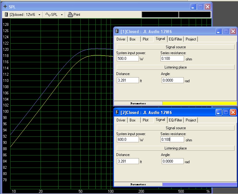

Good point, tcss, and my bad for not looking at cone excursion.  'Very loud' would bottom out those subs in that enclosure.  JL box specs at 1.25 cu ft per sub do protect from overexcursion (at the expense of SQ).  You will get a -12 db / octave rolloff with 1.25 cu ft per sub (using total power for two subs: 500 watts)...which is very much like the rolloff in a vented enclosure.
And it looks like with three subs you would still have to tame the power level in that 4.6 cu ft box to keep from bottoming out, like to about 600 watts.  Three subs looks like your better way to go after all as long as your amplifier doesn't overpower at a 1 ohm load.

WinISD Pro shows me, for two subs, 2.5 net cu ft and maxing at 500 watts.  The blue line shows 3 subs in 4.6 cu ft net and maxing at 600 watts.
