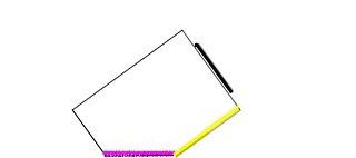

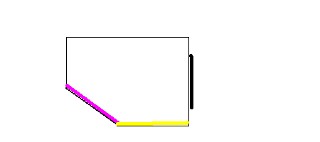

A lot of people who spend some time experimenting with placement find that when the driver side is facing at an upward angle toward the rear, they get best results.  That is as opposed to firing straight forward or straight up.  Here is an example of a box design that would give you the leeway to use it as either straight forward firing or tilted at an upward angle:
posted_image
posted_image
Driver and port opening should be on the same front baffle.  This example shows how you can use your imagination to more easily experiment with firing direction in the vehicle.
There are some SPL builders who have experimented exhaustively on placement, including separation of driver and port firing directions.  These experiments were done for a single vehicle to find highest SPL, and I have heard of at least one setup that fires port upward while the driver fires forward.  The key is that this configuration was specific for that particular car and box build, and nothing but SPL was the intended result.  Sound quality was not a consideration.
