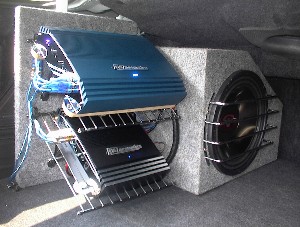

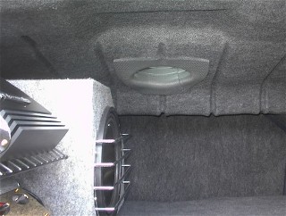

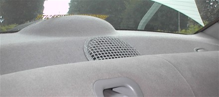

I'll show you some pics of a trunk install I did in my car.  The 12 is facing into the trunk (I actually designed it to face toward center, or side, rather than rear and didn't even experiment with direction like I should have).  The car had a third center speaker cutout in the rear parcel shelf that was used for the factory 6 X 9 "sub".  I used that cutout and fashioned a route from the trunk cavity to the cabin, using a piece of heating duct and a couple of improvised hats (baffles).  The car already has a baffle that separates the rear of the parcel shelf from the trunk and I wanted to make sure I isolated the sub waves from the backs of the rear speakers...thus the length of flexible duct (hidden between the factory baffle and parcel shelf).
On the cabin inside, I mounted a grill and painted it to blend with the carpet.  The sound is really good for a cheap sub and not very much power.

You don't have to aim the sub or port or anything directly into the cabin through the opening.  In fact, it's best if you dont try such a thing.  All that opening does is allow an equalization of pressure from trunk to cabin.
Oh yeah, and don't forget the sound damping to take the rattles out of the trunk.  Any part of the car that rattles at low frequencies will do so no matter where the sub is located, so use the damping wherever you need to.
