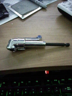

Date Posted: December 22, 2008 at 2:04 PM
i love my skew-driver. comes in very handy for screws in the back deck and behind the dash. i get these at home depot but black & decker sells a cheapo model at wal-mart
posted_image

Posted By: Thack79
Date Posted: December 22, 2008 at 3:40 PM
i second that screw driver. Wish i could find a short drill bit for it tho.
Posted By: soundnsecurity
Date Posted: December 22, 2008 at 4:14 PM
i tried that too but the drill bit wobbles around too much to be useful as a drill
Posted By: thunda_hawg
Date Posted: December 23, 2008 at 12:28 PM
matco makes their  "tight fit" drill set  that works fairly well for me
