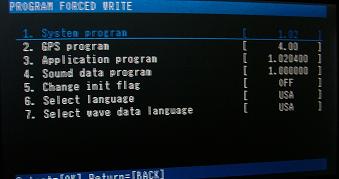

Date Posted: January 31, 2006 at 1:24 AM
ARRRRGH! I hate Internet Exploder!  This is the third time I am writing this as the darn popup blocker keeps erasing my post!
It took me from registering my unit in October 2004 until April 2005 to get my updated CNDV-40MT Version 1.2 software.  It crashed my brainbox after a supposed sucessful update and I had to exchange it out at Bestbuy to get rolling again.  I am scared of using that disc again man.....
Since then I have found a DOS mode workaround that will let me reflash it without swapping or opening anything.  I thank whoever submitted this in some other forum:
steps to flash back the n1 software follows:
Please note, I do not take responsibility if you mess up your nav system. (when the nav is flashing the firmware, make sure theres no power outtage, etc.)
HOLD Eject, Press Reset button.
Screen will go in, and come back out with a black screen and a message about pressing the reset button.
you can releae the Eject button.
now enter the code using your joystick (the control on the right) push UP, Right, UP, Right, Down, Right, Down, Right, then Press in the joystick.
Now you should be in the menu, theres 3 pages of options, the 2nd page should have the option of force flash.
I forgot about what I did.. but I reset the memory, reset whatever info.. which shouldn't be necessary.
Please note that you'll need a remote to have it start programming/flashing procedure. for the voice command steering wheel remote, its the button on the lower left.

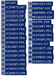

Posted By: Ballerinstaller
Date Posted: January 31, 2006 at 1:37 PM
I believe all the firmware lies in the root directory.  If one can compare all three versions of the disc (40m, 40mt, 50mt)  I am sure the firmware file will show its head with little difficulty.  I have found that for every update, there is a .htm file to show the revision of the file(s) that were changed or that have a revision number.
EU040APL.PRG
UC040GPS.PRG
UC040SYS.PRG
For simplicity purposes, I'd have my deck reset and programmed with the first revision of the firmware.
Using the reduced file version (with poi's removed) so it can be burnt to a dvdrw, I would sub out each one of these files with a newer version until my head unit reported that it was reflashing firmware and viola!  you should have isolated the firmware file and have a name to go with its ugly face.
As long as the updated data files are not encoded differently, which I doubt, the old program files (.prg) should be able to read them.  I just have an issue with the possibility of the renaming of the data files in the newer version whereas the .prg files would not know which to read nor where to find them.

OK- the executable files are these:
1.    EU040APL.PRG   Purpose:???
2.    UC040GPS.PRG   Purpose: Dragon chip driver.  I looked up to see what this may be and I found two references what this may be:
           a. Dragon speech recognition software
           b. Dragon is a Chinese developed MIPS processor
3.    UC040SYS.USA   Purpose:  Navigation operating system
I would try subbing each one of these one at a time by removing the new file and replacing it with the old one, but renaming it to the new version's name.
Then run each one to see which one causes the cutout of the nav/dvd features while in motion.
Thanks for trying it out, I appreciate the effort.

ok i replaced all files except what appears to be the os... and it worked, it recognizes the map data...however when you input a new destination, it returns to the map screen.  I read somewhere to disable the dvd vid feature, one file has to be removed from the dvd.
Posted By: wrecklesswun
Date Posted: February 13, 2006 at 10:28 AM
also has anyone verified that the d1 fix doesn't work for the n1, or that the n1 has the same circuitry as the n2 ?
Posted By: ron_s
Date Posted: February 15, 2006 at 10:48 PM
Does anyone know if there are any ill effects when you upgrade the N1 to V50 and then reset and reinstall back to the V40 version?   Does this reset the learned data in the 3D?  Is there a problem running V50 when you want the extra map data and then reset/reinstall back to V40 when you want the ability to watch movies or input destinations while you drive?
Ron
Date Posted: February 16, 2006 at 8:55 AM
It reverts back to the old ver just fine...
Posted By: ron_s
Date Posted: February 16, 2006 at 8:30 PM
If you rename the files "UC010SYS.USA" and "UC040SYS.USA"  with an extension of ".txt" you can use notepad to open the files.  In the UC010SYS.TXT file (it takes several minutes for the file to load) scroll about 2/3 the way down.  This is where the BIOS menu (all 4 pages) as far as entering the "PASSWORD" as well as formatting the SDRAM option.  Anyone know how to write code well enough to disable the auto BIOS update?
Ron

OOhhh I had fun today reflashing my N1 as another revision of my modded nav discs did not work.
The purpose of this post is to further explain the reflashing procedure and other operation buttons.
Sush1a   Initially gave me the info on how to do this and now I give you the information to make it even easier.
You do not need a remote, at least not on my N1.  I just used the POS button on the bottom of the foldout screen to initiate the flash procedure and the BAND button acts as a BACK button.  Read on to see the whole procedure.
This works on my AVIC N1 so I believe that the buttons that I am about to speak of using will also map over to all other units too.
Unit should be on and do not interrupt power until flashing has completed or you will be sending unit back to manufacturer for Jtagging.  Unit will indicate when reflashing has completed.
I am not to be held liable for any damage to your unit and any of this information put forward is strictly for sheer enjoyment.
1.  Eject any DVD's /CD's from unit
2. HOLD EJECT and at same time press the reset button with toothpick or other tiny instrument.
3.  Keep holding the EJECT button as screen will cycle in and out. As screen comes back out, you can release the eject button.
4.  If all of this has been done successfully up to this point,  you should be staring at a screen that says in black and white "Press Reset Button"  DO NOT press the reset button or you will be doing steps 1-3 again.
5. Now this is the time to enter the code sush1a has provided us. While staring at the monitor screen with the message on it,  now use the Joystick to enter the following movements:
UP   RIGHT   UP   RIGHT   DOWN   RIGHT   DOWN   RIGHT    PRESS IN JOYSTICK  and you should be rewarded with a screen that  has some red in it and dissappears quickly and is replace by one that looks like this:
posted_image
Use the Joystick  and press it to the right once to navigate to next screen:
posted_image
Choose option #6 by pressing down on the joystick until option #6 is highlighted.
Now press the joystick in to select this option.
You should see this screen:
posted_image
For most of us, we will be choosing #1, #2 and #3 and obviously not at the same time.
Next we need to insert the NAV DVD that we want to force flash from.  Make sure it is clean and the right version!
Now it will prompt you with a option of what drive to flash from.  Logic dictates that we will be choosing the DVD ROM Drive.
If you try to start the flash by pressing in the joystick, you are wrong.  As sush1a indicated, you can use the /FUNCTION/ button on your remote to initiate this OR as with my N1, You can press the green POS button (middle button on bottom of folding screen).
Watch the data % and do not interrupt power until reflashing indicates complete!  My unit stopped responding after completing task, so you may need to re-enter service mode again and again to reflash all portions of the OS on your N1/N2.  I cycled power and Ba BOOM!  it reset, re-initialized and pow!  Not even a waypoint or the calibration file was touched.
Here is a file version screenshot for you hAckerS out there:
posted_image
posted_image
Sorry for the long post!

Posted By: fearx24
Date Posted: February 27, 2006 at 12:41 AM
The purpose of this file I found was Application. Also I noticed when I just substituted this file and it installed the Application I was locked out from watching video. Also the menus were all screwed up. I will try installing everything but this once.
Posted By: fearx24
Date Posted: February 27, 2006 at 2:14 AM
In my findings I have found that the EU040APL.PRG application file which is the menus and stuff I think also locks the unit. I tried installing just this and nothing else and My unit was locked from playing video while driving, but when file was not installed the unit was not locked during my drive. The menus where all screwed up though in the GPS.
Date Posted: February 27, 2006 at 10:00 AM
OK i replaced all files in the root, leaving behind the maps files etc, and it seemed to work, again the only thing wrong was the fact that it recognized new addresses, but seemed to be messed up when trying to route to them...now i was readin this https://kiwi-w.mapmaster.co.jp/index_eng.html and it seems that there are pointers to different things in the files...now if we can collectively break up tasking of how to index map data and such, i think we can break this.  IDEAS?
Posted By: fearx24
Date Posted: February 27, 2006 at 12:36 PM
Which files exactly are the maps files?
Posted By: fearx24
Date Posted: February 27, 2006 at 12:45 PM
I notice your link now. So all the kiwi files are the map files?
Date Posted: February 27, 2006 at 12:48 PM
Hmmm you guys found and matched my results exactly.  I also was able to sub out the 010apt from 40mt while  keeping the original 50mt  040APL and unit still suffered from the lockout, but software still at least worked.   I have a friend that is good at hexing things and he said that a 4meg file can't be too complicated and so maybe he could hex it and eliminate the call to monitor the gyro or gps.
Anyone have a 100% proven knowledge what sensor or sensors are monitored?  I am at the point of disassembling my unit and finding if the n-1 can have the resistor mod done to it.

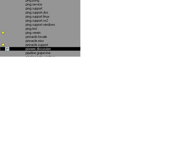

Posted By: explor202
Date Posted: March 07, 2006 at 6:01 PM
It's there, I think you just need a decent newsprovider. I checked Google Groups and don't see it either.  Both Giganews and  Newscene carry it though. Many newsproviders carry free trials, so it might be worth it to join one just to grab these files and then cancel it. I have finally completed my download of disc 1, and am 96% done with the other. However, there's no seeds again, so who knows how much longer it will be.
posted_image
Date Posted: March 14, 2006 at 7:50 PM
posted_image
Here are the files needed to swap...if you can send me those files from the europe dvd, i can try by loading the firmware, but using the us discs

I see on the CNDV-60mp DVD disk all the PIM files for the XM logos. Over on Avic411.com (and probably here too) is the pim manager program to view and convert.
I undertstand that XM change some of their station's names slightly.
However, on my unit EVERY XM station only displays the defualt blue satellite logo (file is something like: LPSNOT.PIM)   What file do I need to modify to get it to read them properly?
This is for an AVIC-N2 unit.

Are you talking about EXCHANGED Xm and Ipod Menu look. This is not Software Related its Hardware you get that not by Updating with software it comes on New Avic-N3. It tells you on Pioneer Site Under CNDV-60MP. Updating with this software doesn't Exchange Xm and Ipod look on Avic-n1,n2,d1

No. I read a few posts back (or maybe on another forum) that the 60mp disks have way better maps, and better graphics and color menus.
I'm in Boston and the maps look about the same.  (although I have not looked deeply into the areas of the "Big Dig".)
The PIM icons of the Xm stations do not display at all.  What is the correct mapping need in the table file?

I believe you will only see the logos on units with the enhanced xm display(D1, D2, Z1, and N3) when used with the GEXP10XMT navtraffic tuner.

I was hoping someone could help me with a problem I'm having. I have a N1 and I reflashed it to the 40 disk so I could view the DVD/Nav while driving. After I did this I can no longer hear the radio or the Sirius coming off the IP bus input. I thought maybe it was the brain unit, but I just bought a N2 and used the N1 brain unit and everything works fine. So now I realize it had something to do with the flash. Hopefully this is an easy fix. By the way everything on the N1 seems to be working fine except the inputs coming off the brain( I haven't tried A rear Cam or anything, just the antenna and the IP bus input). Any suggestions and or solutions I may not be aware off? Thanks in advance.

Posted By: rcattral
Date Posted: May 10, 2006 at 12:22 PM
Goldie, I have this same problem. I re-flashed my N1 to restore the video and my rear cam no longer works. I have not been able to find a solution yet but am still searching.
If anybody has any ideas then I would be happy to try them.
Date Posted: May 10, 2006 at 1:53 PM
Hey, um, I had the same problem having no rear camera video after reflashing and I went into the setup menu and turned the feature back on. I have reflashed mine 14 times now and that worked for me. Perhaps you did not reflash ALL of the files. If you need more info how to flash, view all of the pages of this post and you will find the real guide of reflashing your N1 without the need of a remote and it should work flawlessly.

Posted By: goldiey2
Date Posted: May 11, 2006 at 9:24 AM
Baller , which ones need to be reflashed, because I went through all these forums and thought I got them all.. I think I reflashed like 5 things, can't remember all off the top of my head, but three were the ones you posted in your tutorial.. Not sure but I know when I got the unit everything worked fine(think the 40 was loaded). I upgraded to the 50 and everything still worked fine(no Nav/DVD of course) so I reflashed back to 40 and than both stopped working.. that's when I went in again and started my troubleshooting with no luck.. but I was hoping to run into someone that would tell me specifically which file would cause that problem..I'll keep looking though, appreciate the input.

Posted By: hybridamp
Date Posted: June 13, 2006 at 1:51 PM
Anyone have a current, working version of their IMAGETBL.DAT file that they can post for the CNDV-60 data set?
I have an AVIC-N3 with GEX-P10XMT.
I could swear the station logo/icons worked for about 10mins when I first powered up my new unit, but then as soon as I changed to one of the "new" XM Stations all of my icons/logos stopped displaying. It doesn't even display the default "Satellite" icon, it just has blank gray space on all of the XM stations in the location where the logo should be...?
Posted By: whtcrxghst
Date Posted: June 13, 2006 at 6:07 PM
Its posted on avic411.com
