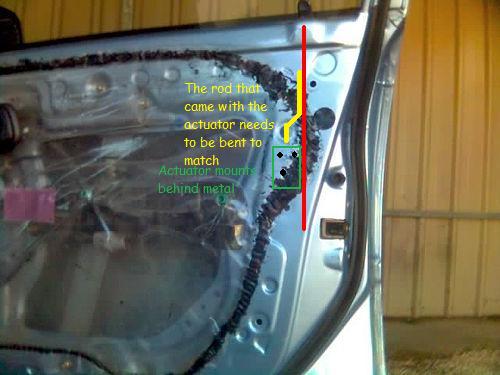

I've been trying to install this actuator on the Corolla for days now. How do you get the actuator wire in there? I am a total beginner, but I've read up on all these tutorials. The cable that I'm suppose to clamp is all the way inside deep in the metal frame. Can anyone help me?

actuators are not recommended for cable lock systems. I would recommend trying to get on a rod at the latch or purchasing the factory actuators.

you will need to mount the actuator behind the metal.  Find a spot that it will fit, mark and drill holes in the metal at the appropriate location.  You will need to use bolts, lockwashers, and nuts to mount the actuator.  It should have come with a metal rod that you can bend similar to the picture above.  The kit should also have come with a metal block to attach the rod of the kit to the rod of the vehicle.
