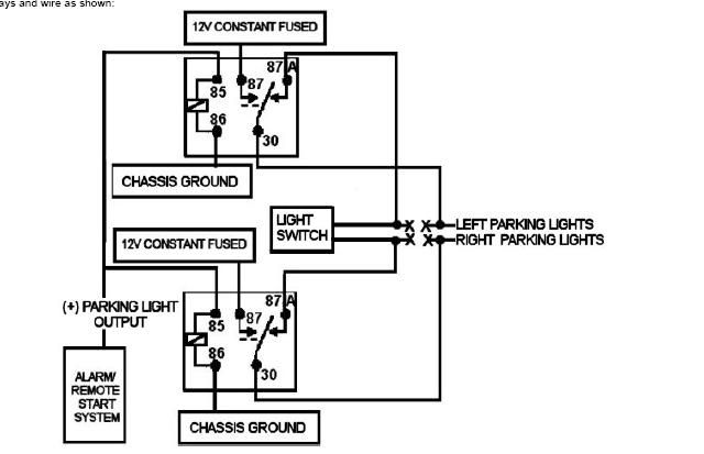

Date Posted: November 03, 2008 at 9:11 PM
Hi,
I am trying to install the autocommand remote starter model 41026T on VW Golf 2002 GLS.I wasn't sure of how to connect parking lights wires, by the way I have two of them. I did find the wiring diagram.Do you think it will work?If not, are there any other suggestions you can give???posted_image
