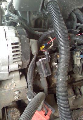

Date Posted: November 06, 2008 at 9:23 AM
Yes i do believe the light comes on when it is remote started.. this is a picture of were i have my tach hooked to.. is this not correct?

Posted By: robertsc
Date Posted: November 06, 2008 at 4:51 PM
what are you using a scotchlock?
Posted By: roooler
Date Posted: November 06, 2008 at 5:59 PM
for the connection? its a T connector cutting into the Tach wire and then the other wire is connected to the T connector with a Flat Male Spade. if that is what you were wondering?
Posted By: scottsstarter
Date Posted: November 06, 2008 at 7:55 PM
Tech wire at ECM , it is right below battery uder black plastic cover. Remove cover pull up metal clip and plastic tab to release.
flip over ecm its tricky at first but you will be able to read numbers under gray wire cover you will see 1 thru 5  remove this with a screwdriver and door panel puller take your time if not you'll splt it in the middle (experance, learn from my mistakes) pin 10 is whit and it is your tach. don't try and guess because there is 3 or 4 whites in here. this is a good location on all GM truck planes(i.e. yuk,taho,suburb,danal,H2, all use same ECM)  thru 08 classics ( not new 08 silverado or duramax).

Posted By: robertsc
Date Posted: November 06, 2008 at 8:07 PM
thats too much work
unsnap the dash 4 screws remove the cluster
tag the white wire
p.s. get rid of those t-tap/scotchlock
they don't belong in any decent install
there a problem just waiting to happen
