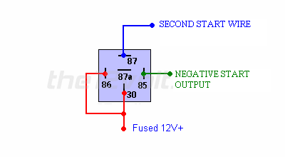

Posted By: ckeeler
Date Posted: December 05, 2008 at 4:31 PM
Yes. ill also post a diagram. there are 2 ways you can do it. if your unit has a second starter negative output (it will be a small wire that supplies a low current negative trigger the same way the purple start wire supplies 12v). if you dont have one on your unit you can trigger a relay off the purple start wire.
Posted By: ckeeler
Date Posted: December 05, 2008 at 4:45 PM
posted_image
OR USE THIS ONE
posted_image

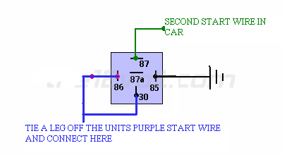

Posted By: nycmaximas
Date Posted: December 08, 2008 at 2:26 AM
Found this diagram online-just wanted to make sure its the correct way to wire up the relay for the 2nd starter wire.
posted_image
For pin 86 on the relay does it matter where it's grounded off?
Posted By: ckeeler
Date Posted: December 08, 2008 at 8:50 AM
no
Date Posted: December 08, 2008 at 4:29 PM
ckeeler wrote:
no
LOL no as in that's not the correct way to wire it or no as in it doesn't matter where it's grounded off?
Posted By: ckeeler
Date Posted: December 08, 2008 at 4:33 PM
just give it a good clean chassis ground. it doesnt matter where.
Posted By: tedmond
Date Posted: December 08, 2008 at 6:51 PM
thats okay to wire like that but i prefer this
85 - constant 12v fused @ 5 amps
86 - negative 2nd starter output from alarm or rs 200ma - 500ma)
87 - constant 12v
30 - to second start wire on car.
this only works if the unit has a negative out for start during remote start sequence only.
Posted By: ckeeler
Date Posted: December 08, 2008 at 7:08 PM
true. i also dont like that diagram that much. didnt you use one of the ones i posted for you earlier on this thread? the problem with using a GWR from the unit is makes the relay energize the second start wire the whole time. you only need to energize it for START.
Date Posted: December 08, 2008 at 7:59 PM
ON SNAP! I didn't even see the diagrams you posted in the previous page. Maybe the pics didn't show up when I viewed that page or something. I will use your diagrams.
Thanks again.
