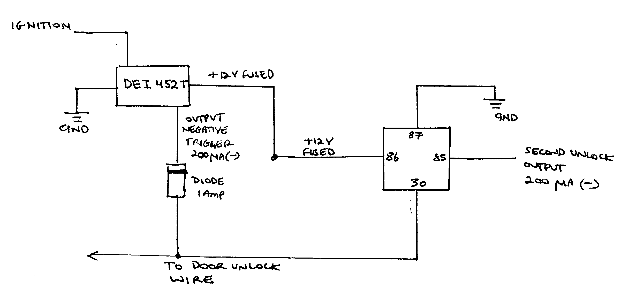

the only thing I can't do is set Auto Unlock, as the door unlock output is dead, & I'm using the second unlock output to open the doors.I am hoping to use a DEI 452T to just unlock the doors (Locking will be RPM based) as follows:
posted_image
My question is that is it necesssary to add a diode as above, between output of the relay & the DEI 452T, to prevent current flowing into the 452T module, whenever the doors are unlocked when disarming.
Thanks

Or look at the diagrammes on this site under relays, or use a 5 pin thus:- ground to 87a and 85, ign to 86 and 30 to lock, no diode required 87 not used, thus  the relay is only energised when the ignitionm is on, opening the lock circuit. To play safe I would substute a 528t (Check the part number set for about 1sec for the relay. I can't see how you are going with your suggestion as it requires neg pulses!
Posted By: Sungura222
Date Posted: February 01, 2009 at 4:59 PM
I see, ok I'II try your suggestion, and go with the 528t.
