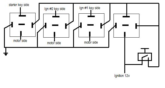

does anybody see a problem usin this configuration to interrupt the 2-12v constant wires on the ignition of a 1998 dodge ram diesel with a manual tranny. the customer does not want a starter wire kill, because the truck is manual. and if i interrupt the ignition 1 and 2 he does not want a theif to crank the starter over and over. he also does not want any switch put on the fuel pump.
how would i add another relay to this for both 12v wires.
would this be a reliable setup. do you think the relays could fail due to heat or continuous use like this. he doesnt mind carrying a couple extra in case one fails. i already warned him if it were to fail the car would shutoff.

I would get rid of the second relay and hook pin 85 of the first relay to constant 12volts and put the hidden push button switch in between pin 86 and ground, that way if someone were to brake in and crank the ign switch the starter wouldn't crank and with this set up if the relay were to fail his truck wouldn' t shut off

posted_image
will this work without overheating?
Posted By: ninno
Date Posted: February 01, 2009 at 5:40 PM
i got the above to work on a bench, i just dont know how it will work under ignition load.
first turn the key to on, then push momentary button which engages ign 1 and 2 and allows switch to crank.
any other ideas???
Posted By: i am an idiot
Date Posted: February 01, 2009 at 6:37 PM
If that is a momentary switch, when you release the switch you will lose ignition power.
Posted By: ninno
Date Posted: February 01, 2009 at 7:52 PM
i  used an ignition switch and harness from an acura legend on a bench with 12v buzzers on the motor side plug. my results:
when the key is turned on, nothing happens until the momentary switch is pressed, then the ignitions 1 and 2 stay powered until the key is turned off. then the whole thing is reset again. the only load on the ign 1 and 2 and starter are 12v buzzer or a meter or a test light.
i dont know how it will act in a car under current load.
but i did build this on a bench and it did work, my question is will this work in a car reliably?
Date Posted: February 01, 2009 at 8:39 PM
I missed the right relay, it's sole purpose is to keep the other 3 engaged. This should work in the vehicle, the relay is capable of 40 amps of current in that configuration, I see no problems with it.
Posted By: ninno
Date Posted: February 01, 2009 at 10:12 PM
thanks again for the answers. i plan to install it monday afternoon. ill let you guys know how good it works.

Posted By: ninno
Date Posted: February 02, 2009 at 9:41 PM
owner did not want any remotes, and also did not want any fuel cut-off (someone else told him that his glowplugs will burn out if there is no deisel in the chamber). he likes to carry a single key without even a key ring.
anyway i installed the above relay set today, and it did exactly what he wanted. the key is turned to the run position and nothing happens till he pushes the hidden momentary button then ign 1 and 2 come on and the starter is allowed to crank. when the key is turned off the whole thing is reset.
thanks everybody for the advice.

Posted By: ninno
Date Posted: February 04, 2009 at 2:47 PM
the whole setup worked just like he wanted(so far). it was installed on monday.
the last relay on the left actually latches on the other three with 1 push of the button. so the 3 relays stay on the whole time the truck is running. and will not turn off until the key is turned off.
im thinking you mean that the button has to be held down during run and crank, but it doesnt.
if a theif jams something into the ignition nothing will happen until the "well hidden" button is pressed. even if someone uses the key and doesnt press the button the truck wont start. if you  look up into the underdash you wont see where i put the relays and all ignition wires were recovered in factory looking tape.
its actually a pretty cool setup unless a relay fails while hes driving, but he took a couple extra relays and understands the danger. i reccomend only starter kills, but hos truck is a manual so this is what he wanted.
thanks.
Posted By: ninno
Date Posted: February 04, 2009 at 2:49 PM
sorry i meant the last relay on the right in my own drawing!
