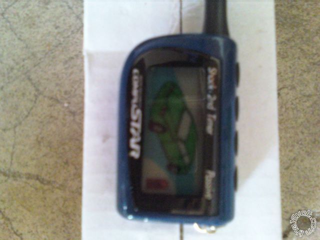

Posted By: prdjr165
Date Posted: May 24, 2010 at 7:57 PM
posted_image
does anybody know what model this remote goes with?
Posted By: dswift
Date Posted: May 28, 2010 at 5:19 PM
[QUOTE=prdjr165]posted_image
If your antenna says ANT-2W900 this is the wrong remote.
You will need a 2W900FMR-3A
On your brain for option 2-5 for ignition controlled door locks:
UNLOCK the controller first to disarm
Press and HOLD 1 + 4 for 3 seconds (one flash/ one click)
Tap button IV 5 times (1 second increments) you are sending RF. you will see one flash each time you press the button.
WAIT 3 seconds
It will confirm 5 flashes
Then TAP button II
You will see two flashes and your Drive lock is programmed.
The parkinglight are essentially important. The clicking noise you hear is the parkinglight relay triggering.
Very simple. It only takes me one try to do this through RF. If you guys are having issues going into programming mode make sure you understand that you guys are sending RF signals. If you don't see a flash, simply let go and try again. You have a 3 second window that the brain waits for RF. If it doesnt see anything it will flash twice and exit out of programming mode.
