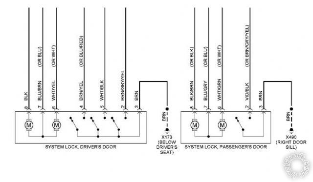

Posted By: rksterling
Date Posted: September 10, 2010 at 12:30 AM
Am I reading this schematic correctly???
Is there more than one wire that has to be tripped at the same time to activate the locks?
I will include a close up of the lock area.

Posted By: howie ll
Date Posted: September 10, 2010 at 1:24 AM
The diagramme is essentially the same except where it says BROWN / yellow going to blue/red, our (R/Hand/Drive) version doesn't have the BROWN / yellow.
From the left on the driver's door you have the first three as motor and deadlock wires,
BROWN / yellow/blue red for unlock trigger,
WHITE/ black for lock trigger
and BROWN / grey with yellow dots as dome light trigger.

Spent several hours testing and found that the BROWN / grey with yellow dots works as dome light trigger when grounded.
The Blue/Red #22 wire & WHITE/ Black #20 wire do not trigger locks at all when each grounded seperately.  When  these two wires were disconnected from the BCM the remote still activates the locks and unlocks them as well.
I disconnected the three wires shown in the diagram attached to the motors one by one.  The blue wire #51 when removed from BCM resulted  in no response on  1st unlock pulse from remote, but unlocked all passenger doors on 2nd pulse. Locked all passenger doors when remote pushed once as normal
With White #13 disconnected the results were the same as with blue wire #51 disconnected.  Upon reconnecting this wire all windows closed
Disconnecting Black wire #32 had no effect on locks the opreated as normal and on reconnection the 1st time windows closed.  They didn't close when retried.
Looking at the Fortin site they recommed using two relays in which each hits both the unlock wire and lock wire at almost the same time.  Tried it with the diodes recommended and it didn't work..  I read some where that Fortin is not correct.
Even more frustrated, but not willing to quit yet!!!!!!
Date Posted: September 11, 2010 at 10:00 AM
I am convinced they changed something up on these north american x3's.  I have held each of these wires for more than 3 seconds.  And I also found that the trunk release works by grounding the grey / YELLOW pin #44.
I am going to try looking at all the wires shown on the diagram for the passenger door.  Different pin #'s but same colors.  The colors on this vehicle are using the alternate colors shown in brackets.  They have done some other alternate stuff by the looks of it.
If the oem remote works there has to be a way to do it with the wiringposted_image
Date Posted: September 11, 2010 at 11:13 AM
If both the blue/red and the WHITE/ black wires are shown in the above diagram as going to ground through a brown wire, would it require a hot to trigger the switch leg shown?
I know that doesn't make sense when I ground out the BROWN / grey / YELLOW the courtesy lights come on as you mentioned they should, but again the other two wires do nothing.  If I disconnect them from the BCM can I try a fused positive voltage through those lines of do i go into a door and try to sort it out there?
Posted By: howie ll
Date Posted: September 11, 2010 at 2:08 PM
Sorry about this but I did another today, E46 Cab and everything was fine. No; if you look at the diagramme, the lock/unlock triggers go to ground, all you would do with a hot feed is blow the fuse! Holding ground to the door light trigger will probably stop the locks from working.
Use the + RED / blue at the puddle lamps for your all door trigger.
You will probably need a dome light delay setting.
