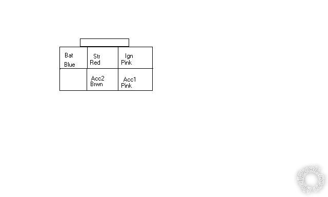

The Rogue has an ACC2 wire at the ignition switch harness.  Believe it or not, you will find two pink wires at the ignition switch. The ACC1 is Pink, same color but seperate wire from the cars Ignition1 wire, also Pink.  ACC2 is Brown.  Verify with DMM.  Is the Python Ignition 2 output selectable / programable to ACC2?  If it does, then program it to ACC2 and connect it to the Pink accessory wire.

1. In the first paragraph you mention the ACC1 is Pink and ACC2 is Brown, but then you say connect the remote start ACC2 to Pink. Did you mix them up? Does it matter?

The ACC wires don't matter for order.  Being as you had the Brown as ACC1, I listed Pink as ACC2, although the wires guides show it reversed.  Here is a crude drawing of the ignition connector :
