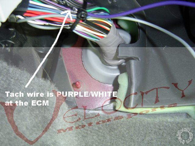

Posted By: Velocity Motors
Date Posted: October 17, 2010 at 10:50 AM
posted_image
Here's the location that I use for the Alero for tach. There are only two VIOLET/WHITE wires and the one to use has a thinner white tracer through it than the other.

Posted By: timo123451
Date Posted: October 18, 2010 at 8:49 AM
Got it! Thanks
