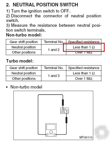

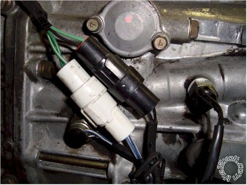

Date Posted: December 16, 2010 at 2:07 PM
zerepdivad wrote:
those don't quite detect neutral but they detect the clutch being pressed.
I see some vehicles really have that switch.
likes pic below, also have actual switch let ECU knows it is neutral
posted_image
posted_image
posted_image
In those vehicles equiped with actuall neutral switch, I guess it is safe enough for 4103XV, because only neutral position pressed this switch seeing ground.
But I am not sure I am right...just get some info online about this.
Thanks for your help
