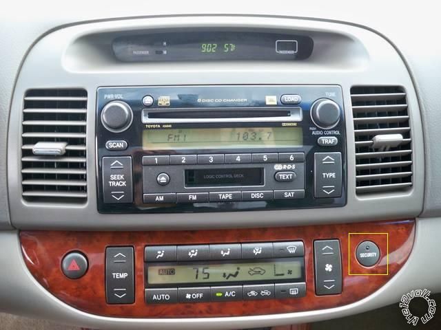

Posted By: flobee4
Date Posted: January 29, 2011 at 9:24 PM
Not all Camry's have a transponder from that generation. I think only the 6 cylinder engines and maybe the SLE trim have them... There would be a security light flashing and would it would stop flashing as soon as you stuck the key in the ignition but not turn it. The security light is in the bottom right of the picture. I put a yellow box around it to point it out.
