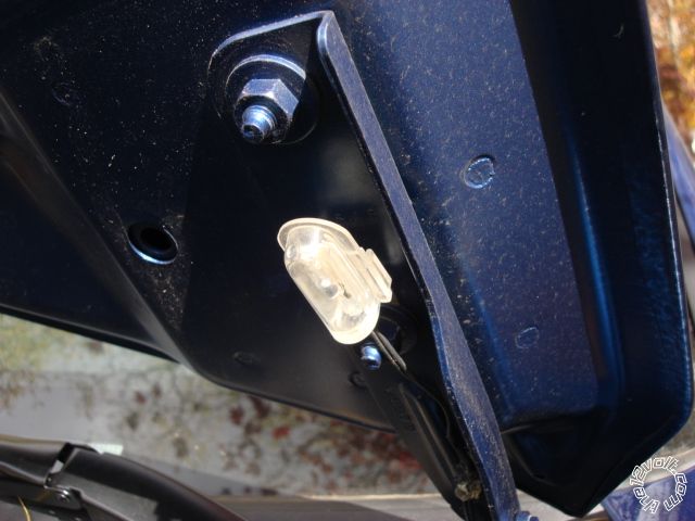

Re -  Hood Pin
An alternative to the hood pin switch is a "mercury switch" or tilt switch.  Newer ones use a roller ball instead of mercury.  No holes to drill and they don't rust and seize up.  They work well in flat terrain but can be a bad choice in places like San Fransisco where the vehicle could be parked on a steep hill.
posted_image
Search on AU-46 or DEI 8613.
