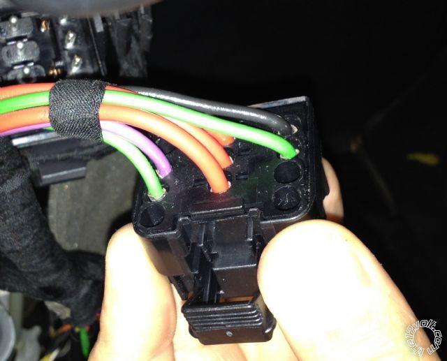

Please do me a great favour and load a photo of either the rear of the ignition switch or the ignition switch loom.

Date Posted: November 10, 2011 at 10:13 AM
posted_image
here is the pic , those 2 green are 12 volts when i turn key to ignition , and are hot while cranking !
3 red are constant 12 volt
and violet turns hot when i turn key to ACC position !
so my connection from viper was
3 12 volts to reds
ign1 ign2 to those 2 greens
acc to violet
starter wire to black
Used the valet key worked like a charm !

With a multimeter and the ignition off, see if those greens are continuous, i.e. joined. If so you you only need connect 1!
