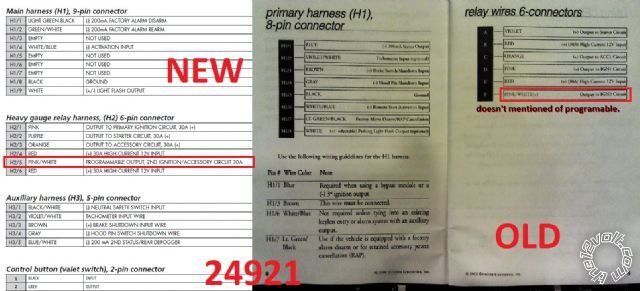

I have ready remote/a vital 24921(older model).
Its has 2 ign output but only one access. I thought I can program ign2 as access but I don't see it in the booklet.

The Pink/White wire is programmable to accessory 2 under menu option 6 according to the Installation manual that came up when I Googled the model number.
Posted By: voltswagon
Date Posted: January 07, 2013 at 5:41 PM
yea, that's the ign2. Remember this is the older model 24921, how to tell is the antenna is just a foot of wire.  On the booklet that came with it, it doesn't mention/show how to program it.
So back to the question, do you know what/which each accessorie wire control?

never seen that unit... No manual for it that i can find. So we'll go back to the "old school" approach to making you a 2nd accessory output.You will need to diode isolate(both bands towards the brain) your status output(ground while running) wire so that it feeds your bypass and the new 2nd accessory output relay that you will need to wire in. The relay wiring is as follows:
85 status output of remote starter
86 accessory wire from remote starter(just need to tap into it)
87 Fused Constant 12 volts
30 Output to 2nd accessory wire
Now I'm giving you these directions because the best practice is to duplicate all wires that get power with the key. You want the remote starter to mimic what the key does. Failure to do so can cause check engine or ABS lights to come on or transmissions not shifting correctly.
If you truly are set on seeing what each accessory wire does, Simply jump the 12volt wire over to one of the accessory wires and see what comes on. If you are lucky, you would want to find the accessory wire that turns on the radio. Some cars have an accessory wire that only powers things like radio and wipers, other cars power those items and an ABS or Transmission computer. Hook it up without the accessory wire that turns on the radio and try to remote start it. If it doesn't start or it does start and you get a check engine light or ABS light then you know you'll need to add the relay in anyway. I personally bench prep all my work, to add a relay in takes 5-10 minutes. If you had to do it while its already installed in the car, it can take you 45 plus minutes. Much easier to just do it the right way the first time... Plus it save your back from the extra 45 minutes...lol

Date Posted: January 08, 2013 at 9:35 PM
Here's the comparison of new and old.
posted_image
posted_image
About the relay, I'm not worried about it.  I just didn't want to use one/two if I didn't have to.  In this case, I might have to.

Posted By: flobee4
Date Posted: January 08, 2013 at 9:58 PM
I see now, so either wire in a relay like I showed you and get a true extra accessory output and don't use the pink/white off the remote start.
or
Do like Mike M2 said and hook up the pink/white to the accessory wire that turns on the blower motor and heater control. The side effect is that the heat will continue to blow while the car is starting. This is not a normal function, but he says it would work fine on this car. To test which accessory wire turns on the blower motor, simply turn the heat on and then jump each accessory wire one at a time to the 12volt wire in the ignition harness. The one that turns on the blower motor is the one that gets the pink/white wire.

Date Posted: January 08, 2013 at 10:47 PM
I just had to prove I'm not crazy posted_image
Yea, I dont know why I wasn't thinking of that.  12v+ to one of the wire to see what comes on.
Thanks for your help.  I will discontinue this thread and continue on the other one I started.
Meanwhile, I know I'll be doing more of this so I just order 10X 20a/30a w/ wires relay $20.
