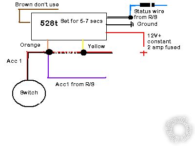

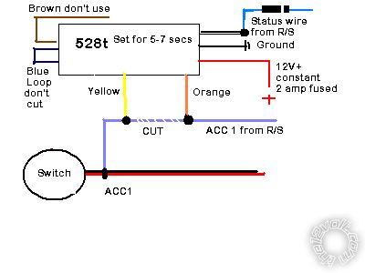

You could use a 528t timer, set up to delay up to 3 minutes, it will handle 30 amps, one for each accessory wire.

I found someone on YouTube achieve the 'AC delay using the 528T' in their odyssey, however, he didn't post how he accomplished it.
I am hoping this will solve my problem.

OK, here goes.
You have 2 ACC wires, find the one that controls the HVAC.
One might control the HVAC, wipers and washers.
The other just the radio.
You don't even need the second any way so lets call the one you need ACC 1.
Cut this wire.
With the 528t join the ignition side to ORANGE.
Car side to YELLOW.
12v+ to RED.
BLACK to ground.
BLACK/ WHITE to your status output wire or factory disarm if the unit has one.*
BROWN don't use.
Set the timer to about 15 seconds, you can tell by watching the internal relay contacts move.
*The second method is safer but whichever you use diode inline, band towards the R/S.

Posted By: howie ll
Date Posted: January 23, 2012 at 7:21 AM
Connect after your join, yes to the diode it's a precaution.
Yellow/Orange? I don't know the year of your vehicle bit neither Directwire for Canada or the US list that colour from 05-11.
Posted By: ngooo
Date Posted: January 23, 2012 at 7:22 AM
Would it matter if i connect the 528T yellow/orange wires to the point A or point B?posted_image
Posted By: howie ll
Date Posted: January 23, 2012 at 7:29 AM
No but since there's electronics involved stick to my list, it's proven.
Orange = 87a
Yellow = 30
Brown = 87
Red = 86 or not relevant
Black = 85 or not relevant
BLACK/ white =85 or 86 if you cut the blue loop (don't in this application).

Posted By: howie ll
Date Posted: January 23, 2012 at 8:59 AM
That drawing doesn't really tell you anything!
Look at this:-
Posted By: offroadzj
Date Posted: January 23, 2012 at 9:08 AM
Now here is a question Howie. Why cut the factory wire? If it is starting fine with the key then why not just connect the acc from the r/s to the 528T, then the 528T to the accessory wire in the car???
Kenny
Owner / Technician
KKD Garage LLC
Albany, NY 12205
Posted By: ngooo
Date Posted: January 23, 2012 at 9:26 AM
As per the wiring info on this site, i connected the ACC1 at the plug in the left kick panel.  I am not sure if i should connect the 528T closer to the plug in the panel, or on the other side.  No idea where the switch is.
Of course, if i could just tap into the R/S ACC1 line as Kenny has mentioned, none of the above matters, and that would be nice and easy.
Posted By: howie ll
Date Posted: January 23, 2012 at 9:29 AM
You're absolutely right, that's the problem with thinking up stuff on the fly posted_image
