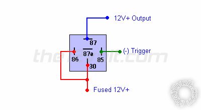

dome light supervision, how do i wire a relay for a 2007 chevy monte calo? any help will be appreciated.
"the hotness"
Posted By: howie ll
Date Posted: July 02, 2012 at 12:04 PM
It should be in your alarm install instructions.
Posted By: smokeman1
Date Posted: July 02, 2012 at 12:15 PM
What Remote model are you working with?
Posted By: herb-anthony-jr
Date Posted: July 02, 2012 at 12:41 PM
PYTHON 5303P for 2007 chevy monte carlo ss
"the hotness"
Posted By: shortcircuit161
Date Posted: July 02, 2012 at 2:08 PM
On the Python system's main harness, you should have a negative BLACK/ white dome supervision wire.
Since this car has a positive wire for the dome light, here is how you wire the relay.
posted_image
Dome Supervision      gray/black      +      BCM, pink plug, pin 1
Notes: The BCM (Body Control Module) is under the driver dash, to the left of the steering column.
Date Posted: July 02, 2012 at 2:12 PM
I'm sorry, I realized I left out some info. You would connect the 86 and 30 pins to a constant 12v source.
The 85 pin of the relay goes to the BLACK/ white trigger wire from the Python system.
The remaining pin 87 of the relay goes to the dome supervision gray/black wire on the Monte Carlo.
Hope that helps!
