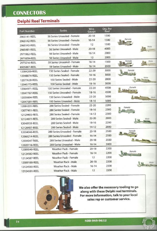

Posted By: metz35
Date Posted: December 03, 2012 at 9:52 AM
Terminal supply company sells the tools and the individual pins for all plugs including the plugs them selves. They have all molex Bosch Delphi there catalog has pictures so you can match it up
Posted By: metz35
Date Posted: December 03, 2012 at 10:06 AM
posted_image
Posted By: howie ll
Date Posted: December 03, 2012 at 11:40 AM
Got a link young man?
Posted By: soundnsecurity
Date Posted: December 03, 2012 at 12:25 PM
sweet, i guess thats as good as it gets.
