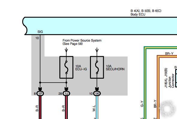

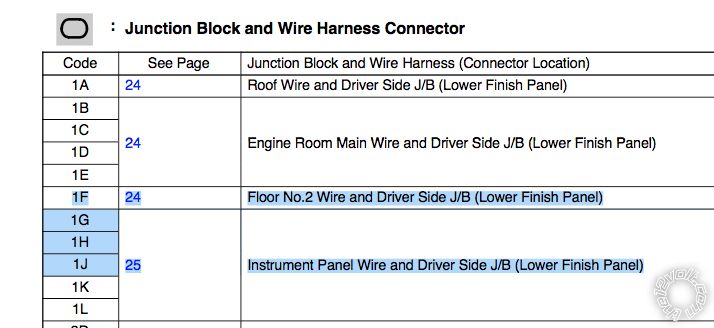

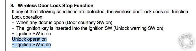

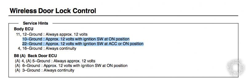

I thought I'd update everyone on my quest. The answer seems to be that once the 4runner is under control of the add-on remote start, my only option is to use the key to enter the truck.
I found a diagram for a "Door Control Receiver" which is housed in the Driver's D Pilar behind and/or above the rear tail lights. It has four connections which are:
Ground -- Always Ground
+12V -- Always at +12
RDA -- Data line sends coded pulses to send lock and unlock messages
PGM -- Used when programing new key fobs.
Those are the only four connections, so I don't believe that there will be a way to fool the door lock controller into thinking that the ignition is off while the car is running.   I *might* try tapping into the RDA line and see if I can read the pulses with some custom programming logic, and use that to trigger door lock, unlock etc on my own... but that project would be for another day.

I also found documentation for an '03 4 Runner that states that the remote lock and remote unlock will not work if the ignition switch is "On". From the logic involved and the wiring diagram, it seems that the Body ECU will always receive the lock or unlock commands from the Door Control Receiver, so I guess here's what I *might* try.
The body ECU has a BLACK/ Red wire at pin 10 that is the secondary ignition, and it appears to be an input (sensor) wire. So I could try cutting that wire, and connecting it to the Yellow/Black wire (to keyless ignition input) on my remote start.
That SHOULD make the body ecu think that the ignition is off when the car is running under remote start.
I guess my only concerns are can I isolate just this wire (it's inside a grey box on toyota's diagram), and will the change have other negative consequences. I don't know if the Body ECU control anything truly important (like engine management). I see that it DOES control windows and locks and also the Anti-Theft system.
(Relevant pages attached and quoted below. Source: LINHSY from T4R.Org
Sorry for the images... not allowed to post PDFs yet.)
<quote>
System Outline
Door lock control (Lock and unlock), back window control (Back window open) and panic control (Theft alarm and flash) is performed by remote control, without the ignition key inserted in the door key cylinder, using low–power electrical waves emitted by a transmitter.
3. Wireless Door Lock Stop Function
If any of the following conditions are detected, the wireless door lock does not function.
Lock operation
∗ When any door is open (Door courtesy SW on)
   ∗ The ignition key is inserted into the ignition SW (Unlock warning SW on)
   ∗ Ignition SW is on
Unlock operation
   ∗ Ignition SW is on
<end quote>

The "Grey box" appears to be "Junction block and wire harness connector"
posted_image
To me that means that it is probably a special "pig tail" type connector that plugs into a junction block, has it's own internal connections within it and then has a plug to plug into a wire harness.
posted_image
Based on that information you will want to focus on the connector at the left driver's side kick panel, and find the connector into the "Body ECU" that includes pin numbers 10 on the Body ECU (the "SIG" stands for Secondary Ignition" -- i think). The wire should be in a pigtail or wiring harness and inside that harness Body ECU pin 10 should be connected to Pin 8 on connector "1F" which according to the image above connects the "Floor no 2 wire and driver side Junction box (Lower Finish Panel)".    Inside that pigtail harness, the same pin should also be connected to pin 28 on 1J which is the "Instrument panel and driver side junction box (lower finish panel)"
So you will have to examine that connector, and find the right wire to cut.
As indicated in the "Service Hints" (below)
posted_image
On the ECU, both Pin 10 and Pin 22 are at +12V when the ignition switch is "ON".
Inside the harness, cut the wire where it leads into pin 10, then test to see if you can unlock the doors when the engine is running via remote start.
If cutting the wire inside the harness that connects to pin 10 still doesn't give the desired response, you may need to cut the wire that leads to body ECU pin 22 as well -- since this wire is +12V for the ignition switch in both "ACC" and "ON" position.
Both of those pins are at +12V (in reference to ground) when the ignition switch is "on".
If it does work, then you will need to have that wire (or wires) disconnected when the remote start is running, and connected at all other times.
Do this by adding one relay for each wire that needs to be cut, and connect them so that the wire is normally connected when the relay is not powered, and when the remote start has the engine running, the relay is powered causing the the wire(s) to be disconnected.
When remote start isn't running, the relay (or relays) will close again, reconnecting those wires.
posted_image
If you go this route, don't forget to put a diode across the correct relay wires to prevent voltage spikes when the relay changes state (search and read for info on this if you are not familiar with what I'm talking about... it's a very standard issue and solution for hooking up relays), Because these relays will be connected to on board computers, you don't want to risk damaging them due to voltage spikes when the relays are triggered.
I feel confident that this should work for you (or anyone else), and will not pose the types of risk that I was concerned about. Of course, you will have to carefully examine and test the pigtail/wiring harness, because the schematics don't tell you how it is wired internally -- and I am assuming that it is in fact WIRES and not -- for instance -- a circuit board, that makes the connections. Whatever it is, if you do it, please post photos in this thread so others (including myself) can see.
