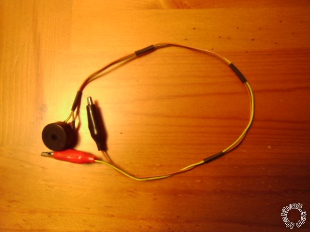

Personally, I feel the Horn beep is a very valuable audible confirmation tool while programming the Ultra Start
units. When I program the bench prepped unit ( still on the bench ), I connect a small piezo tone generator to the
Horn output wire to help me thru the programming menus.
posted_image

It would be cheaper just to connect the U1272 to the vehicles horn wire, but here is an inexpensive piezo
buzzer from RadioShack : https://www.radioshack.com/product/index.jsp?productid=2062397 The Black lead
goes to the U1272 Horn Output and the Red lead to +12V constant ( either thick U1272 Red wire ).
