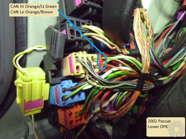

Don't do many VW's but with the iDatalink modules, they specifically say the vehicle must have "electric windows" for the modules' CAN functions to work.
The other thing I noticed and it might just be a change between the model years, but here is a photo of the CAN wires in the DKP from a 2002 Passat and the plug is Yellow, not Orange.  The CAN wire colors are the same.

I've got power windows and locks. I don't think I've ever seen a B5.5 generation without them actually, even my no frills 2000 has them. The plug changes color slightly from year to year but it's between a burnt orange and yellow on all the ones that I've seen. I did a scan with VAG-COM, a third party diagnostics program for VW/Audi and didn't get any errors on the CAN bus. I'm loading the firmware in the dball via the web interface on the xpresskit website using an xkloader2. The firmware I'm using is 401.VWAUDI 2.03.04. If D.E.I. had older firmware I'd try it, but they'll only allow download of the latest one and even that seems to be a P.I.T.A.

I ran the wires for W2W between the dball and 5904 this morning to see if that made any difference. The only change is that now the r/s disables the factory alarm on start. The only wires that tie into the factory alarm are the CAN bus wires. This thing is frustrating as all h*ll. The CAN wires in the pic above are what I'm using, the same pair in the dball install guide, the same in about every other CAN adapter install guide I can find as well. I'm guessing at this point that I have a bad dball or that there is something wonky in the firmware?
