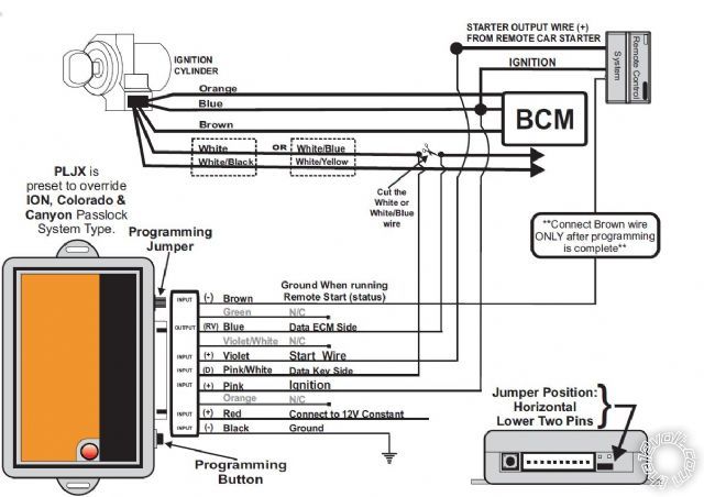

Posted By: voltswagon
Date Posted: December 16, 2013 at 5:44 PM
for Chevy Colorado, there's no starter wire.  There is a wire that need to split.
When I say I have to reprogram the bypass, i mean learn the code/key or whatever you call it.
I'm absolutely sure everything is correctly wired.
91stt] wrote:
ecause you say that your car would not start without reprogramming the bypass leads me to believe that there is a problem with the installation. Please list the exact wires from the RS and what they are connected to in the car. Also list any wires that you had to cut to make connections. Include the wires used from RS to bypass module.
Here is a new find, this might be it, I will have to try it Wednesday.
posted_image
Dont Drive and Text, but
Do Text Then Drive
Posted By: 91stt
Date Posted: December 17, 2013 at 12:04 AM
The key does not rely on the bypass module in order to start the car. The key should always be able to start the car, even if the bypass module is dead. Clearly this sounds like a wiring issue.
Humor us and tell us how you connected everything so a proper diagnosis can be performed. It is hard enough to try to diagnosis problems on the web, it is harder when there is little information provided.
This information is provided only as a reference.
All circuits should be verified with a digital multi-meter prior to making any connections.
Date Posted: December 17, 2013 at 3:29 PM
I disagree.
With correct wiring, if your bypass is not learn/programmed it will not start because the DATA ECM/KEY is spliced and has to go thru the bypass module.
Anyway, here's the picture.  Also got a reply from Bulldog Security Support.
posted_image
Here's from Bulldog support:

Posted By: offroadzj
Date Posted: December 17, 2013 at 5:17 PM
Yes the factory wire gets cut, but it is run through an internal relay in the bypass that is closed until the remote start activation signal tells it to open (and send the learned signal to the BCM). It is specifically designed to be closed under failure so it should never prevent the car from starting. My money is on a bad connection as well.
