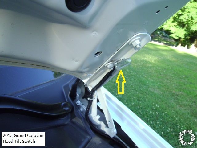

Sorry, you will need red butt connectors also to connect the siren to the siren wire and connecting the mercury hood switch to the hood trigger of the 5303.
This is a mercury hood switch:
posted_image
This is one installed(borrowed from a member on here):
posted_image

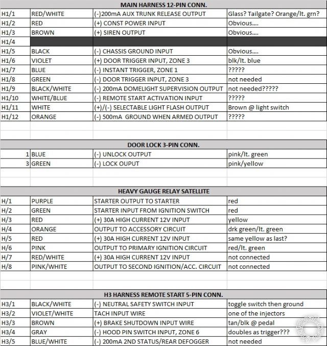

I appreciate the info I have been provided with so far. Here's what I have figured out from the various guides for wire colors, locations, etc. There are a few that I don't even know if they need to be connected. Also, The Fortin bypass says it needs a ground when running(GWR) from the RS. However, the stupid install guide quick reference doesn't list that, but rather it has ground when armed... 2 of them! If someone could clue me in as to if that is just improper terminology on the part of 2 different companies, that would be great. Please help me fill in my blanks! lol
posted_image
