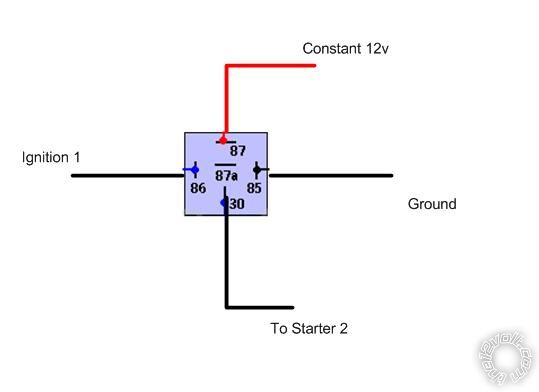

Are you saying the ignition1 wire from the truck will trigger the relay to provide power to ignition 2, same goes for the starter wires? It took me a while to think about what you said. Let me draw out a diagram and you can confirm it for me.

Posted By: qpham504
Date Posted: February 25, 2014 at 11:26 AM
My mistake thats suppose to be Ignition 2, not Starter 2.

Posted By: freqsounds
Date Posted: February 25, 2014 at 12:44 PM
Yea, it's a relay for ignition and a relay for starter.
No, don't cut anything or the physical key won't work! :-)
