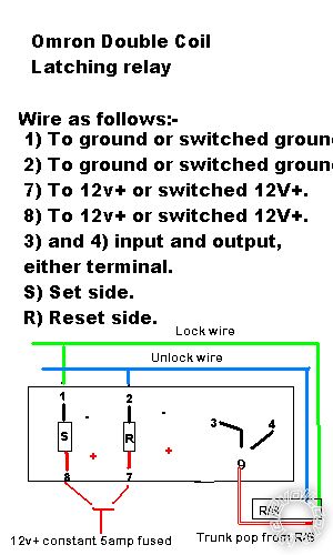

Hey Thanks for your input on this...I found this relay diagram what do you think about this setup....
posted_image
i won't be using the OEM remote at all just the RS remote...so i can you the negative unlock pulse of the system to turn on the relay which would output to the GWR wire of the FLCAN...and use the lock pulse to turn off the relay??? or maybe even use the GWR signal from my RS to turn off the relay unit while also activating the FLCAN.
Posted By: howie ll
Date Posted: April 30, 2014 at 12:13 PM
You could do this with a single dual coil LATCHING relay, triggered to on by unlock or as Chris says door trigger from driver's door shuts off
When it gets a starter pulse.
As a point of interest the status or GWR wire on ALL of the systems I've come across should go yo ground immediately the R/Start is enabled.

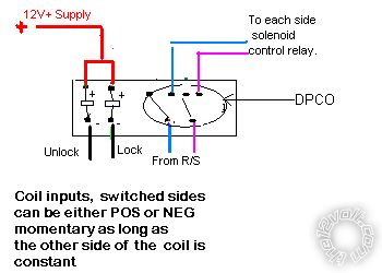

Posted By: howie ll
Date Posted: April 30, 2014 at 2:32 PM
First picture gives you a typical circuit, second a part number, available from Mouser, Farnell, or RS Components UK:-
