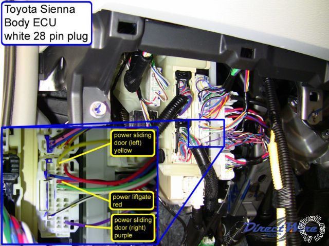

Posted By: kreg357
Date Posted: November 03, 2014 at 7:12 PM
Most shops want to save time during installs.  Soldering the connections requires more time.  Done properly, nothing beats a quality solder connection.  Done wrong, soldering can cause big problems.  It does require practice & some skill along with decent tools.
If you have a DMM, are handy with a soldering iron and don't mind spending a few hours on your knees with your head next to the steering wheel, the car is pretty easy to do.
I kinda like the Audiovox Prestige APS687E for this install ( even though I used a Compustar on the last one ).  The Viper 4606V is another good choice, but a bit more expensive.  With the Viper, you have 4 AUX outputs.  Using them from the remote is painless.  If you want AUX3, you press the "f" button 3 times, then the AUX button.
Here is a photo of the Body ECU ( under the driver side dash ) where most of the connections can be made :
posted_image
 Using an APS687E with a PKALL will run about $110 and give nice results.  Going to a local shop and getting the Viper will go about $450.

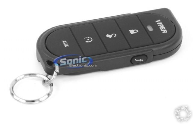

And when you buy a remote start and bypass module, do they come with at least something to indicate what wire goes to what? Ex, purple with white tracer goes to ignition signal, etc etc. Or are there no directions at all? I have read there is barely any support for the diy'er.
Posted By: t1snwbrdr12
Date Posted: November 03, 2014 at 7:33 PM
posted_image
Is the viper I was considering if viper is that much better. How would you use aux functions passed aux 1? I don't see an f button. The owners manual wasn't very clear to me. And viper is apparently the worst for the average consumer to install because they don't give a diagram or info?
Posted By: kreg357
Date Posted: November 03, 2014 at 7:49 PM
Very true.  The manufacturer's will not warrant or provide Tech Support for DIY'ers.   The Viper installed price might
start looking better when you think about the lifetime warranty and lack of 6 hours of your own labor.
On that style remote the "f" button is on the side.  Here is a photo from an EBay listing that shows it better :
posted_image
