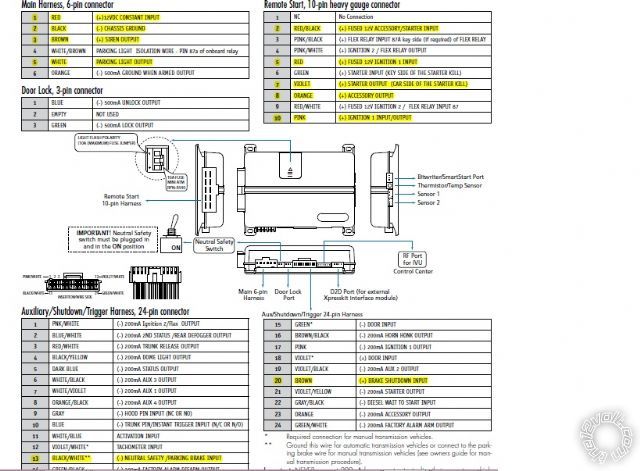

Guys i have one question please
regarding the car starter wire
in the viper guide there are 2 wires
6 GREEN (+) STARTER INPUT (KEY SIDE OF THE STARTER KILL)
7 VIOLET (+) STARTER OUTPUT (CAR SIDE OF THE STARTER KILL)
my question is
1- should i cut car starter wire and hooked up the 2 wires in the viper as guide said ????
2- Or just hooked up car starter wire to VIOLET (+) STARTER OUTPUT ???
Also, i attached this image of what wires should be connected.
posted_image
Posted By: howie ll
Date Posted: January 04, 2015 at 6:35 AM
First answer is safer (anti theft) second answer, easier.
