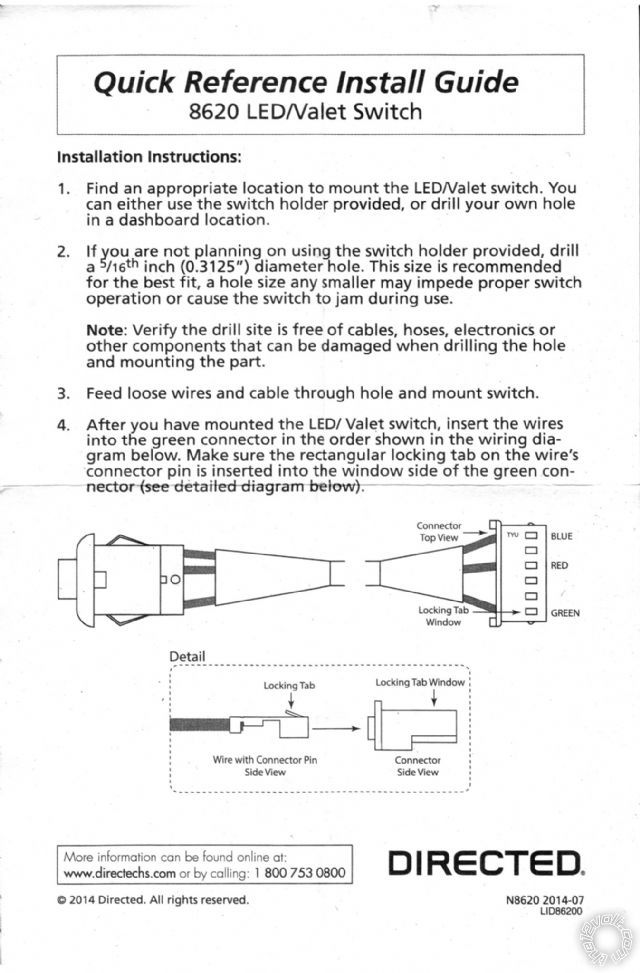

Hey kingvinnie I seen a pic of the Led/valet switch that comes with the kit and there are only 3 separate wires coming out of it blue/GREEN/ red with there own little pigtails I guess you can call it.
How does this plug into the green 6pin port on the brain.
Also thanks for helping me out.
Posted By: KingVinnie
Date Posted: January 17, 2015 at 8:28 AM
it comes with the green molex connector piece too. They leave it separate so the wire will fit thru the hole your drill for the switch.

Ok I see I got a green 6pin antenna cable that came with a VIPER SMART KEY DSK100 I'm thinking of splicing into that witty a alarm Led (blue and red wire one)
Would you happen to know which slots or the order the blue and wires go in.
I want to match them to the one I have to make sure they are right.
Posted By: u1cracka
Date Posted: January 17, 2015 at 2:10 PM
I just tried hooking up the blue and red wires to the blue and red wires on the green 6pin wires and the led lights up even when the alarm disarmed or armed and it doesn't blink.
Date Posted: January 17, 2015 at 9:13 PM
posted_image
KingVinnie
Posted By: u1cracka
Date Posted: January 18, 2015 at 12:48 AM
KingVinnie wrote:
posted_image
Thanks kingvinnie I got it to work using that pic you posted.
