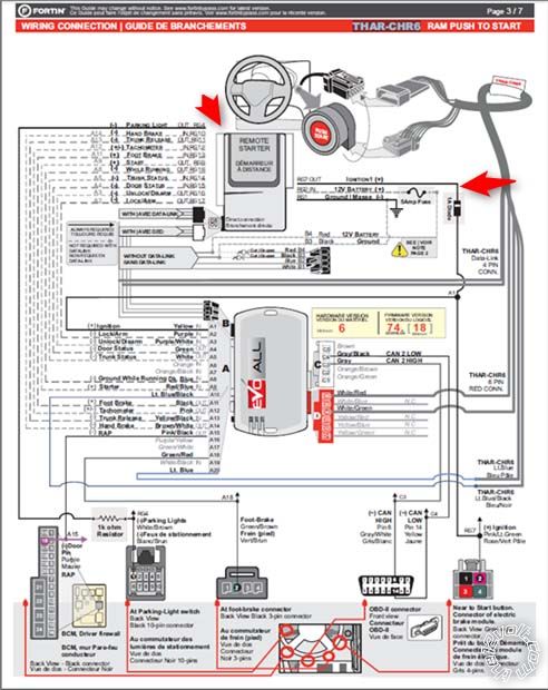

Date Posted: June 20, 2015 at 1:27 PM
My RAM is a PTS truck.i have Fortin EVO-CHRT6 Databus Bypass Module - EVO-ALL Combo with THAR-CHR6 Harness Do I have to install the line show with a red cross to the remote starter if yes where is it
posted_image

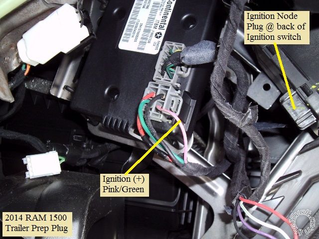

Posted By: kreg357
Date Posted: June 20, 2015 at 3:13 PM
Not exactly sure of your question.  The Red Arrow points to the R/S's Ignition1 output.  You didn't mention which brand and model R/S you intend to use and each will be different.  If you are asking about where the RAM 1500's Ignition wire connection is, here is a photo :
posted_image
While this Pictorial was on a non-PTS truck, many of the connection points are the same ( Parking Lights, CAN, IGN1, etc. )
https://www.the12volt.com/installbay/forum_posts.asp?tid=138747

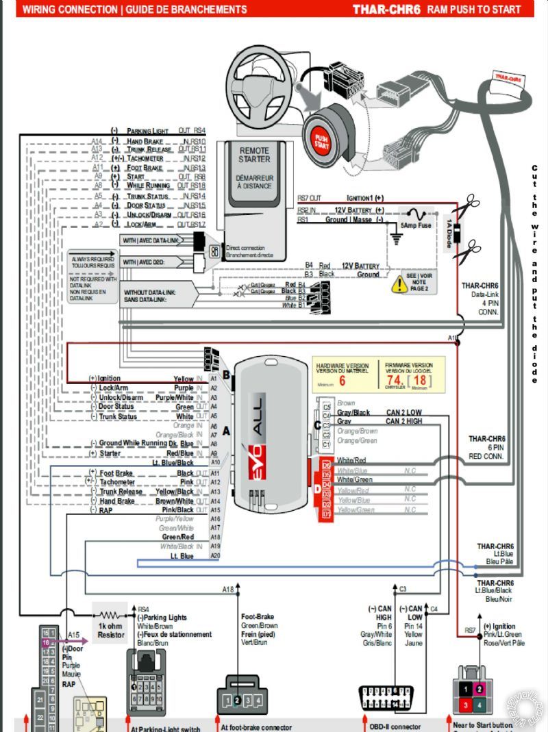

Posted By: bernateau
Date Posted: June 20, 2015 at 4:28 PM
should i do like this
posted_image

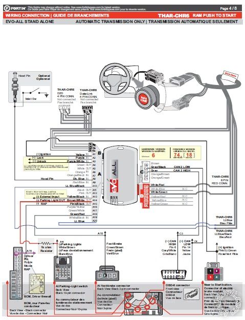

Date Posted: July 25, 2015 at 5:27 AM
hello I need help I have a 2014 ram 1500 with push to start factory remote start and I install a Fortin module with the T harness I want to connect my new alarm excalibure AL-2060-EDPB but in the diagram of the alarm they say connect the starter and the ignition to the by pass module but where and which wire
posted_image
posted_image
Posted By: mpe235
Date Posted: July 25, 2015 at 8:06 AM
In this diagram it shows A1 yellow wire as ignition and A9 RED / blue as starter.
