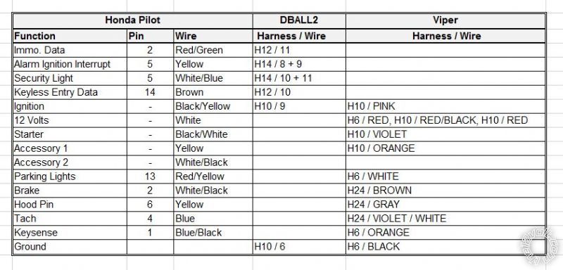

It's been a busy week at work. I have made a reference sheet for the RS and Dball wiring (attached image below)to the car. Appreciate if someone could verify it for myself and anyone else looking for similar information?
Thank you everyone for your valuable time.posted_image
