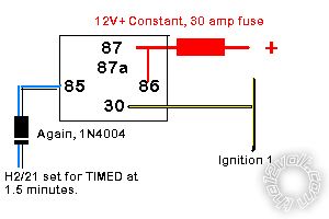

It's all wired correctly, guess I'm out of luck on this one. The only other option I considered to do is wire a relay that will only allow it to connect to ground while the ignition is on, so when off it will be unable to connect to ground.

Here's one:-
Red oblong to right of relay should be 30 amp fuse.
