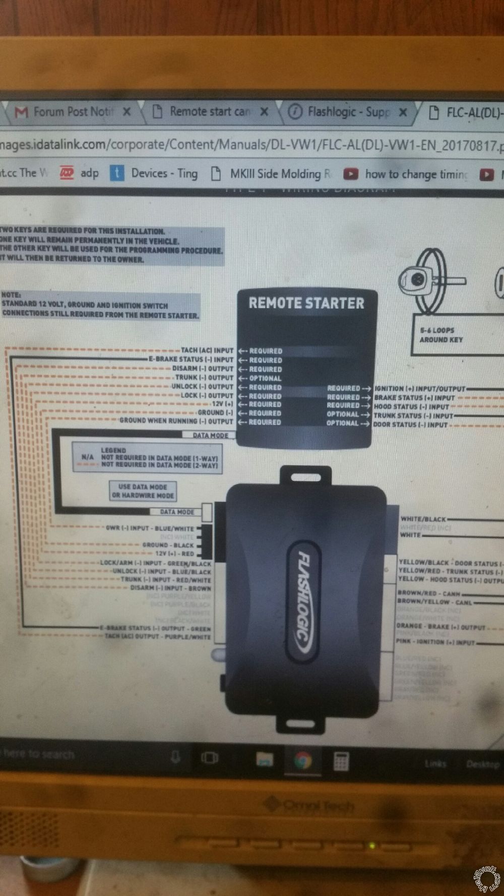

Thanks. I have verified I have ground on the black/white wire when the e-brake is engaged. I also verified the toggle switch is on for the remote start. I was researching last night and one person contacted viper with the same issue and was told there where several defective brains that had the same problem. I am not sure they where the same model # but I am leaning toward that unless you have an idea on what else it could be. The GRW is supposed to be hooked up to the module per the flashlogic install guide.
posted_image
Posted By: howie ll
Date Posted: December 29, 2017 at 2:21 PM
You wrote door lock module that's why I questioned it, also you should have 2 status or GWR wires, the dark blue and a blue/white so the diode isn't needed.
Posted By: bill7774
Date Posted: December 29, 2017 at 10:46 PM
I was actually going to use the blue/white for the rear defroster. I will plan to use the dark blue and diode isolate for my GWR. I was a little confused on that. I was tossing around the idea of using the blue/white wire for the rear defroster and heated seats. The defroster is a +latched. If I understand correctly I will need to switch polarity with a relay and will have + 12v for the preset time to power the rear defroster when the temp is below 55 deg. My thinking is that I can also use this relay to power the heated seats at the same time. Does that sound correct?

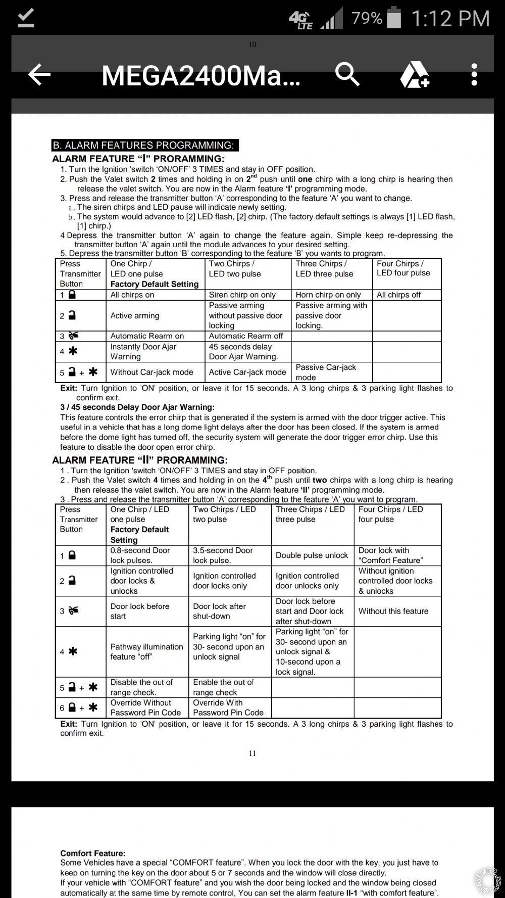

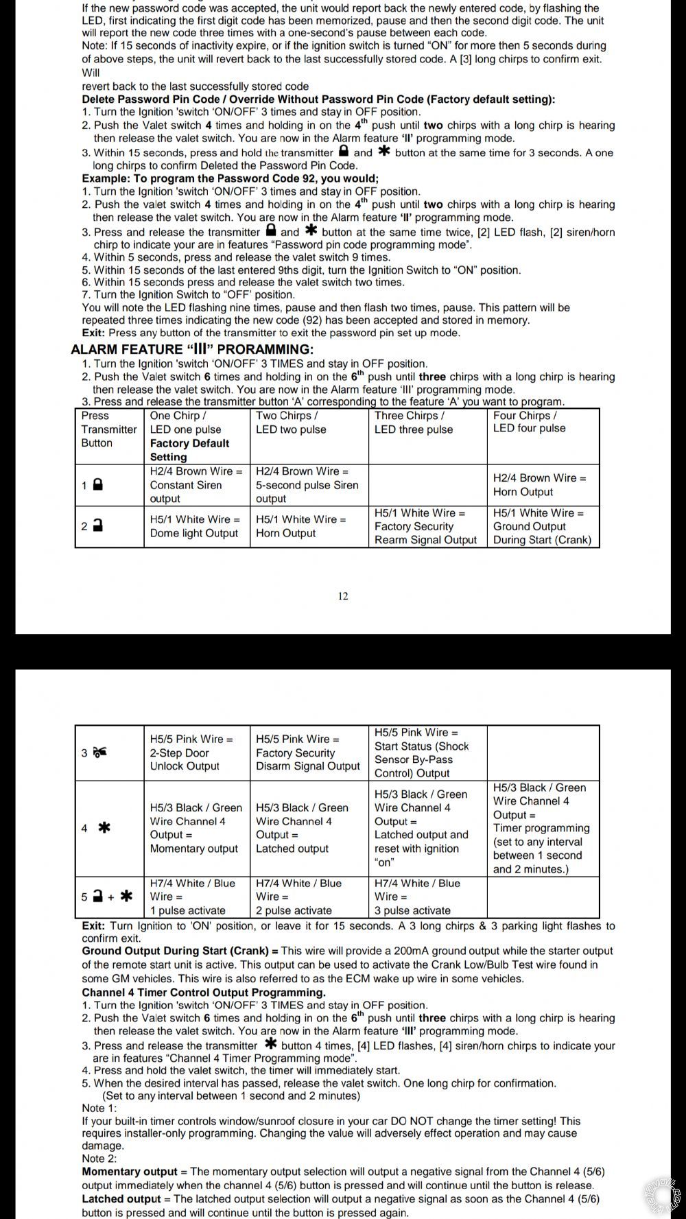

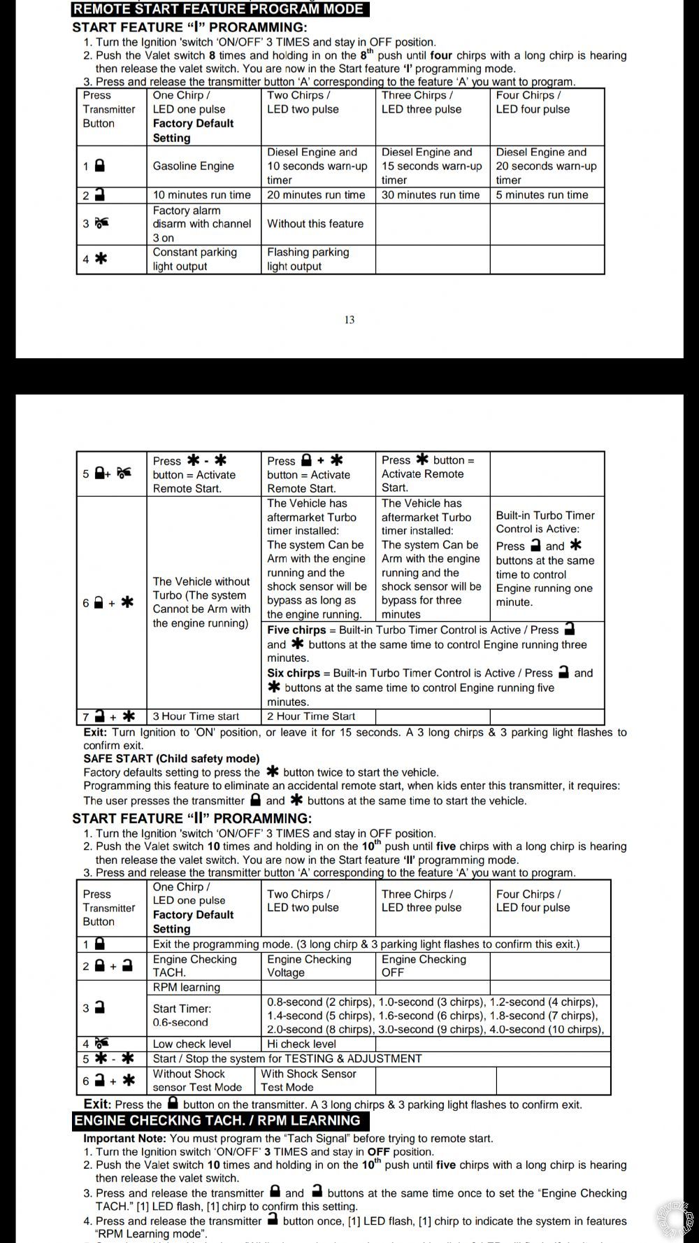

Is there a way to fix the same problem on a Megalarm MEGA2400? Thats whats in my other VW Jetta.
Posted By: howie ll
Date Posted: January 10, 2018 at 7:17 AM
Only if you show the install sheet or programming.
Posted By: bill7774
Date Posted: January 10, 2018 at 4:18 PM
posted_imageposted_imageposted_image
Posted By: bill7774
Date Posted: January 10, 2018 at 7:24 PM
I think I figured it out. There is a wire that needs to be programmed to disarm the factory alarm. It gets hooked to the unlock wire and sends a negative signal when the remote start is activated. I don't remember programing it so I'm guessing I probably didn't hook it up. :).
