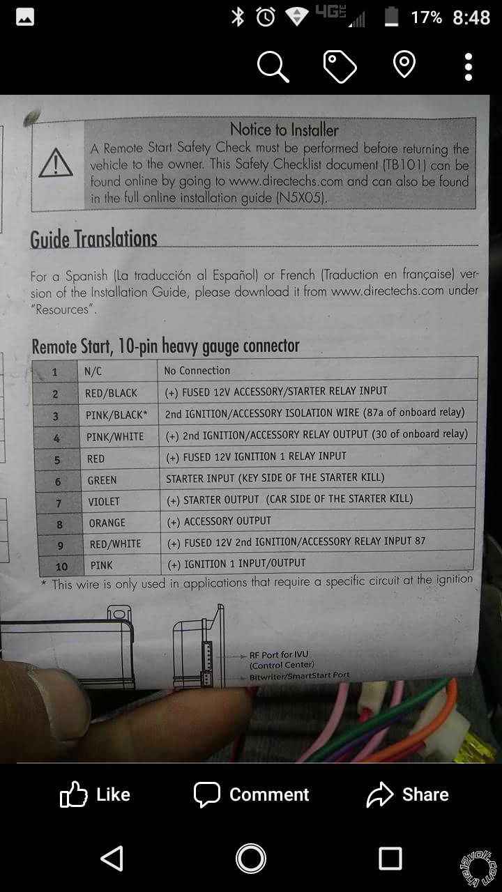

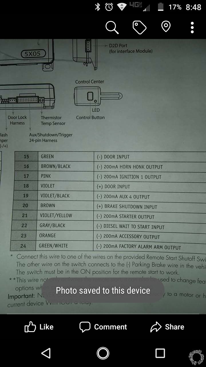

Python model 5305P
I need help with the whole remote start side of the alarm.
I have the keyless entry part installed. I'm just lost with this 2nd ignition and all that. posted_image posted_image posted_image

Posted By: jpadj22
Date Posted: March 04, 2018 at 9:28 AM
You’re Car doesn’t have a 2nd ignition. All you need to hook up is ignition,starter and accessory.
No better feeling then getting a remote start to work right!
Posted By: howie ll
Date Posted: March 04, 2018 at 12:33 PM
Not needed don't bother.
But do power up ALL of the fused wires.
Posted By: 1320cb7
Date Posted: March 04, 2018 at 2:13 PM
So I need #6 & #7 for starter #10 for ignition 1 also #5 needs constant power what about #1 fused 12v accessory /starter kill relay input?
1320cb7
Posted By: howie ll
Date Posted: March 04, 2018 at 2:23 PM
Yes.
Red
Red/white
Red/black
and red on the other harness must all be powered up.
You can also program the pink/white on the main (high current) harness as your second ACC.
Seriously if you have to ask these questions should you be attempting this?
Possibly the most simple install around.

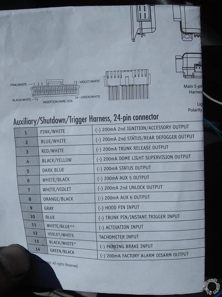

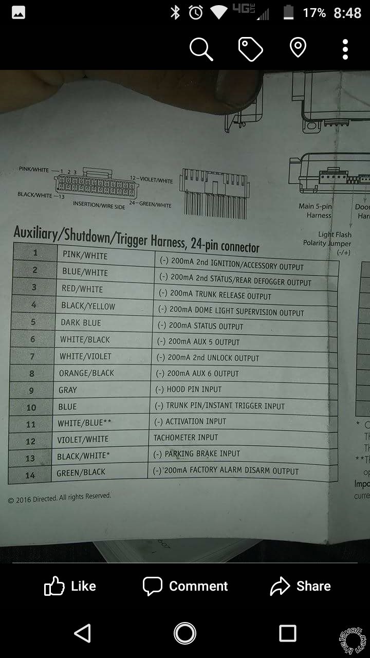

Date Posted: March 04, 2018 at 4:20 PM
Just wanted to make sure... Which ones do I use?? posted_image posted_image

Posted By: jpadj22
Date Posted: March 05, 2018 at 9:53 AM
You need to look at the 10 pin heavy gauge harness to do the remote start. From that 24 pin harness you would have to connect the black/white to ground and the violet/white to the uncommon color at a coil. Best of luck.

Ty very much! The remote start is done. Just needed help with this last bit. Just want to make sure I have everything lined up correctly before I start stripping and soldering

Posted By: kreg357
Date Posted: March 05, 2018 at 10:40 AM
Just a few thoughts. The info given so far is accurate for a 1990 Honda Accord with Automatic Transmission. If your car
is not an Auto Trans vehicle, there are many things that must be done to ensure a safe install.
Assuming Auto Trans, there are at least 2 more connections needed from the 24 Pin harness.
You will need to connect the (+) Brake wire, Brown wire at Pin 20, to the vehicle Brake wire,
GREEN/WHITE (+)   @ SWITCH ABOVE BRAKE PEDAL.
The (-) Hood Pin wire, Pin 9 Gray wire, should be connected to the kit supplied and installed
hood pin. This is an important safety feature.
On your older car, I would suggest connecting the Tach wire to the vehicle's Blue wire at the
distributor. This provides a stronger signal that a F.I. Additionally, a Tach Learn will
have to be successfully completed.
Additional connections might be needed if your car has the factory alarm system but you mentioned
that part of the install was OK.
