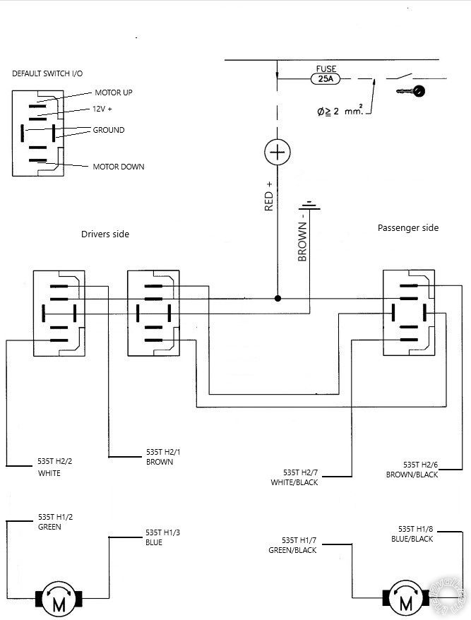

Posted By: jamescourt
Date Posted: April 20, 2020 at 12:06 PM
Right, I think I have sussed out the wiring for adding an additional switch in the drivers door
so I can operate the passenger window from the drivers side.
Please can someone take a look and confirm it is correct?
posted_image
That just leaves my other question that I would like the ability to unlock/lock all doors when I manually pull up/down the drivers side door lock. I thought by installing a 5 wire actuator in the drivers side door would achieve this, but i don't know how?
Date Posted: April 25, 2020 at 6:08 AM
OK, the above wiring for the power window switches is correct and works well.
