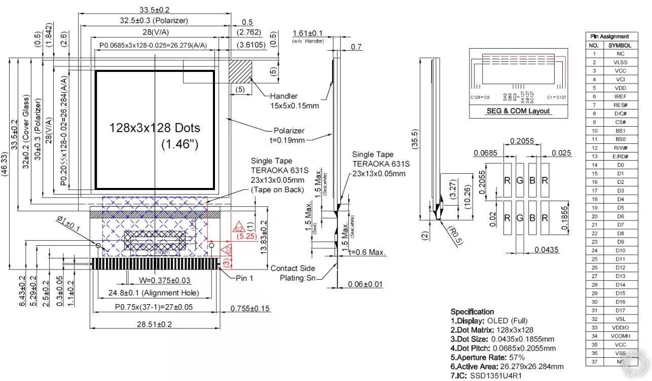

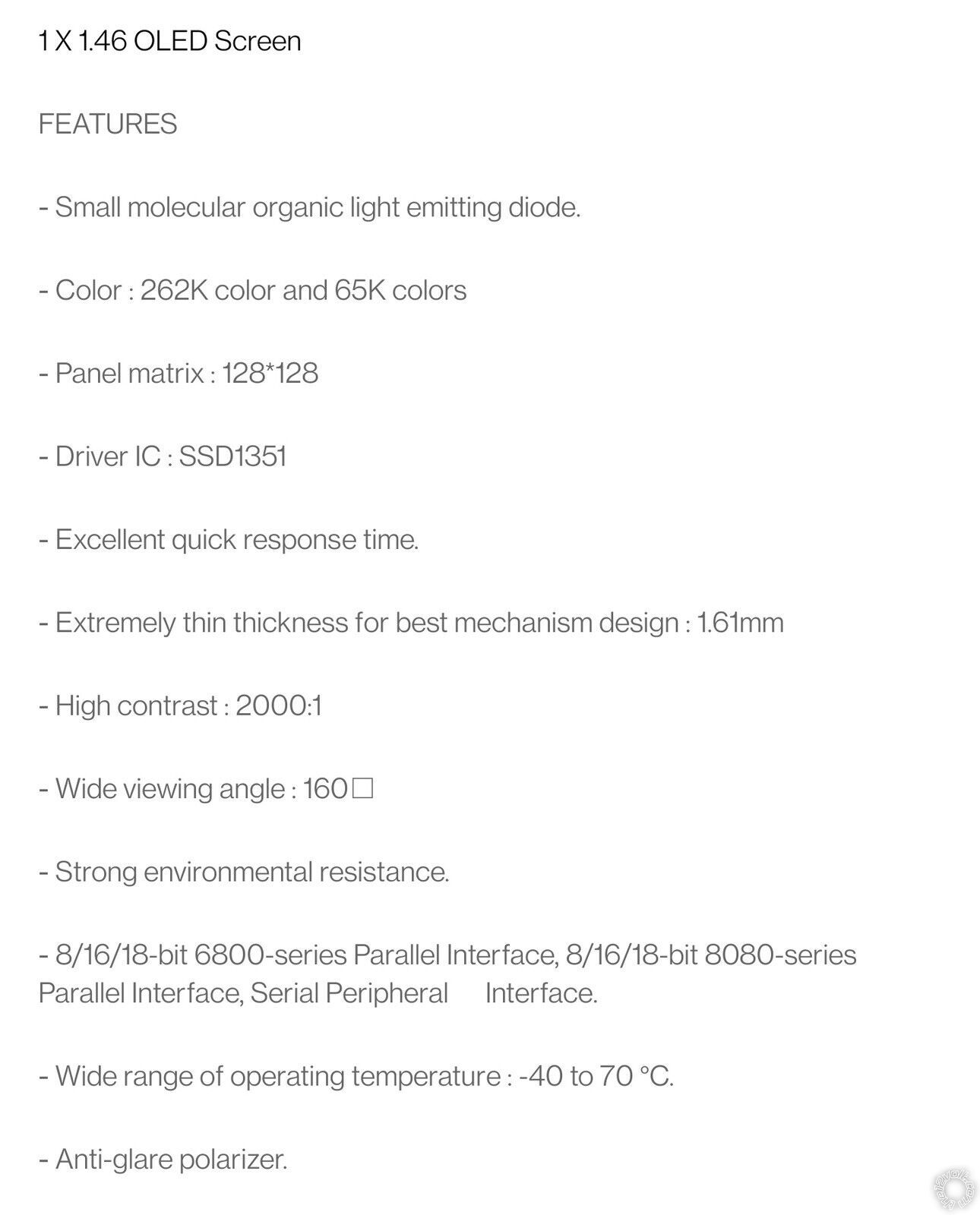

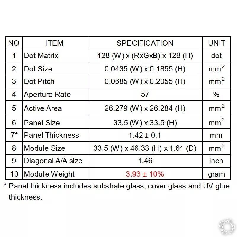

I also found more specs of the screen
posted_image posted_image posted_image
