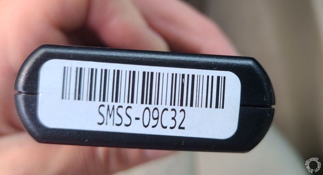

Posted By: bienio
Date Posted: June 19, 2021 at 10:38 AM
posted_image
In your opinion guys what symbols represent that photo? Is it SMSS-09C32 or SMSS-O9C32 Is it zero or O? The guy who activated put O and guy from other store said its 0 in my opinion it's also 0 (zero).
bieniek
Posted By: mgoetz74
Date Posted: June 19, 2021 at 11:19 AM
just looked it up and its activated- this is the second numbers you listed first ones don't exist
Air ID: SMSS-O9C32
Installation Date: 5/26/2021
System type: Digital/D2D (02)
RSSI: -63 dB
Number of satellites: 8
that's all the info it gives me, no personal info or anything just that its activated and it has reception
Posted By: bienio
Date Posted: June 20, 2021 at 6:58 PM
Ok. Good thanks for that info mgoetz74.
