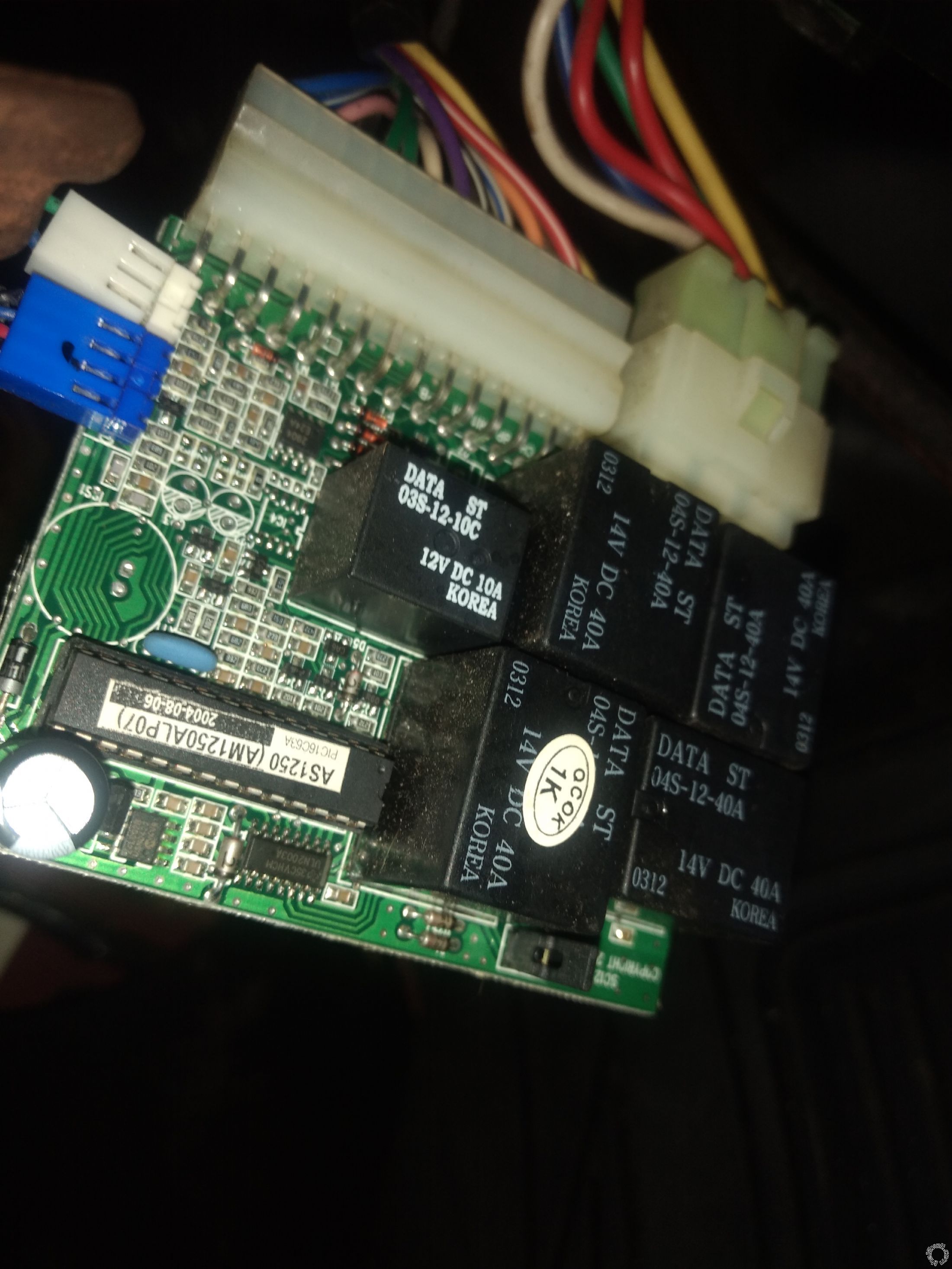

Well I opened it up and the board looked fine no burns or anything Im not sure how to test the relays all I have is a lil circuit tester prn that lights when I ground it and hold it to a fuse a light comes on. I took some pictures I'm attempting to post while I was talking the module apart a couple connections came undone I attached them again but now my auto start don't work posted_image posted_image

Hello been having problems with my headlights not turning on when I autostart/ unlock/lock doors ended up being a bad connection coming from the light output of the brain and my brown headlight wire whoever installed them didn't even put any electrical tape on it, anyhow I followed the white wire down to the harness and there is a small brown mark on the harness but while I was at it I took the brain apart to see if it had any damage to the board luckily there was none, while double testing the wire while pressing lock unlock nothing was happening but the clicking was still going on, I decided to put my tester on what reminds me of a two legged staple directly under the white wire on the board and to my surprise while clicking the remote it was flashing lights and clicking, so anyway I can fix this? Would it be safe to pull the white wire from the harness strip it some and attach it to the 'staple" on the board? posted_image i posted a pic so you can kinda see a basic idea of what I'm talking about thanks
