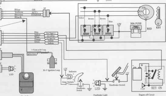

Date Posted: November 24, 2003 at 10:26 AM
heres the schmatic that i'm trying to explain its small but hopefully u can see what i'm talking about

By the looks of the schematic, the relay needs to be between the 12v+ source at the ignition.
When you tun the alarm on the, relay can switch to disconnect the 12v power so the car cant start And vice versa. The acc off port wire also goes to the relay too. This must be how the car senses when the car is on to stop it from cranking over.

I think i understand what you are getting at with that relay.  the +12V to the key ignition needs to be cut and the relay put in place of it.that way when the alarm is ingaged it opens the circuit in the rely so no 12v.  i was going to take a multi metter to thaat ACC out and see what happens when it happens.  I swear I'm going to redraw this diagram to help every ones else out once its figured out!

ok I have the ACC line hooked up and my Q is now does that "Ignition senser" from the schematic go to the ignition coil, or a spark plug or should i just try it on the Tach line?

Ok, sorry but this will be a long one.  I will try to summarize the prob.
Please refer to the attachment on previous post for schematic that I may refer to.
Ok, remote start is installed except for one wire.  This wire is called, according to the manual, “Ignition Sensor” other notes around it “5-7 Circles on Hi-V loop”, “Hi-V Ignition Loop.”  “For diesel engine, Please connect this Black wire to the AC generator output (+) which recharges the battery.”  So I’m 99.9% sure this is what checks to see if the engine has started by using a High Voltage line such as an spark plug?!?!?! So I believe this is what happens based on what I have observed:
1. push start button on remote for 3 sec
2. checks to make sure brake is not applied and that hand brake isn’t high (I used a toggle switch)
3. turns on the ACC and ON relays
4. turns on the start relay, engines begins to crank for ~1sec
5. checks to see if “Ignition Sensor” is high
a. IF YES, Then engine has successfully started.
b. IF NO, Then it adds .5 sec to the crank time and begins at step 4
So this is what is now happening: I have the “Ignition Sensor” wire shoved on a spark plug wire I believe plug 1.  I’ve also tried it on plug 4.  The car begins to crank and after that initial crank it just stops, but the car hasn’t started.  It doesn’t try to restart.  So the unit must have checked that “Ignition Sensor” right after it tried to start and saw that the line was high, because the car wasn’t able to catch, you know kind of stutter, but during the start process there is still residual charge still left in the spark plug lines.  So there I don’t know what to do.  Secondly when that wire is attached to the spark plug line and the car is started by key.  It runs rough.  I’m not sure if its cause one of the spark plugs isn’t making a good connection or if its just because there is a long wire coming from the engine compartment to underneath the dash.  I believe it’s the second one.  So yeah, that’s where I stand.
SO I leave it up to the ever knowledgeable Steve or anyone else out there that has any bright Ideas!
