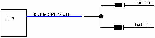

Is this the correct way to hook up the hood and trunk to the same wire (using diodes)? Are they facing the right way?
posted_image
Q: What's the best nation in the world?
A: Donation!     Donate to the12volt.com
Posted By: geepherder
Date Posted: February 02, 2004 at 8:45 AM
Yes, that's correct.
