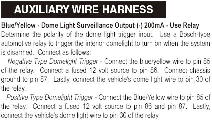

Ok how do i do this im have a ALPINE SEC-100S alarm. Im not using my dome lightsupervision output so its free how do i wire this with the relays?

Assuming your domelight supervision is negative output, use it to provide ground on the coil of a relay, then use 30/87 on the relay to switch +12V to your parking lights.

This is copied from the Alpine SEC-100S / SEC-150R system. Hookup the relay as described below (depending on if the parking light wire your using is positive or negative. Obviously put pin 30 to the parking light wire instead of the domelight wire like it lists..
posted_image
Good luck,
Mike
