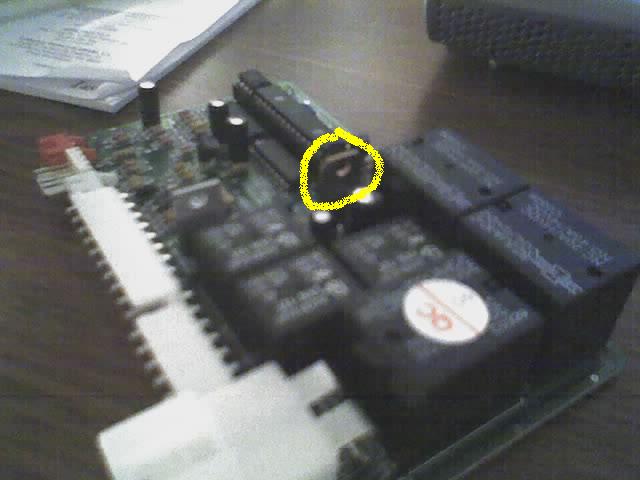

OK,....heres my dilemma,.....im installing an alarm on my sisters Grand Cherokee,......its a remote start/alarm pager combo from Ebay,....a friend of mine has it in his maxima and its working well with no problems,....
but,...my problem is this,.....
I have everything wired to the best of my knowledge,...the remote start was working perfectly, and the alarm as well,....until I remote started and got in to de-activate,....when I stepped on the brakes/w key in the on position, the siren came on,...and just stayed on,....it is on all the time now,....this happened before and I thought it was a defective alarm,....so I sent the brain to be replaced and just got it back 2 days ago,......now after doing this over again,....I opened up the alarm and found a burned regulator?? (i think?)...(I attached a picture of it)...This had happened to the brain I had the first time, but I did not think too much of it,......I just need to know,...if I can replace this part, or should I bother the seller to replace under warranty again?...also......do you think something is screwed up in my wiring?......if so,....what,.....?....to my knowledge,...everything is correct,....but then again,.....if it were I wouldnt be needing help.....anything helps...

What wire did you use on the brake side? It should be the WHITE/ Tan.

       It would be helpful if you tell us what wires you used and their polarity.  So we can better help you understand the problem.
