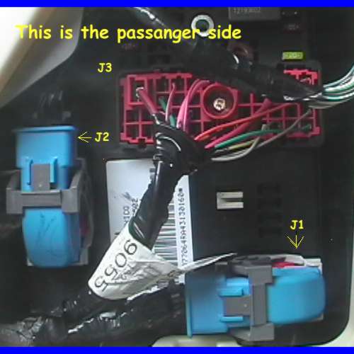

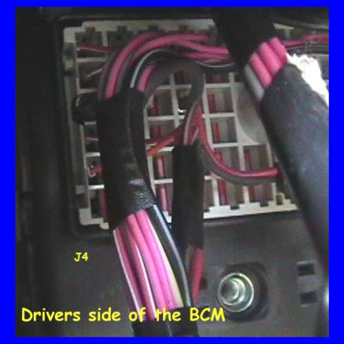

So let me get this straight the brown wire  Is the C4 plug well C4 isn't that on the right side? or is it also on the passanger side?  So my blue ACC (blue from the remote start wire) goes to this brown Ignition or does my second Ignition go to this wire.
The twelve volt source goes to the 12 volt red wire of the remote starter module what else goes to that.  does my Yellow start wire from the remote start go there also?
Does my ignition wire brown from the remote start does it go to the yellow ignition wire in the car?
C4 is the one on the back side of the BCM reached on the driver side isn't it?  Please help I am lost on this car? just please clear up?  See when you look at the BCM J1 would also be C1 right and and J1 runs horizontal and blue and grey.  J2(C2) is vertical and the connector is blue and grey.  J3 Is a big red one it also runs horizontal.  Where is the C4(J4) is it red and on the back side or is it on the passenger side?
Posted By: j68rh
Date Posted: July 07, 2005 at 7:54 AM
posted_image
posted_image
these pictures are of the BCM and where the connectors are
